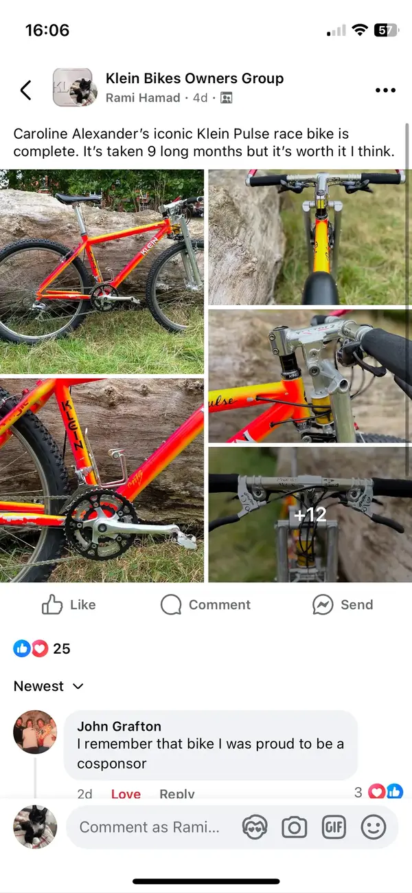

Well done! I feel awful pointing it out after you've been wrestling with the post, but the Moby is back to front.
Text and graduations to the front. Probably "Easton" to the rear.
The clevis pin inserts from the front, with the bolt at the back.
Just saying..
i have to say i think this is a really great project . . . but . . .
please fit the top chainring correctly, the other 2 are aligned correctly with the timing mark in line with the crank arm but the top chainring is not aligned with the crank arm, the timing pin facing out is supposed to sit behind the crank arm, this is for gear shift timing mark but also so that if the chain goes over the top of the chainring then the chain shouldn't get caught behind the back of the crank arm.
sorry to be a picky git! 😬
Many thanks indeed. The lord knows I have tried this but the large ring doesn’t seem to go under the crank arm as stud/guide (?) collides with it. 👍 Besides, this is Caz’s ring on Caz’s crank and it appears she rode it this way so I’m not going to change it. I hope that makes sense.
hmm . . . odd. if the back of the crank arm has a stud to combat chain drop, then the timing pin should be removed from the chianring and then fitted behind the crank arm, i understand the "she rode it like that" but that would have been a mechaincs choice, and arguably wrong choice!
sorry though, i couldn't help but notice it, saw this at the malverns on every other bike last year, i've innadvertantly started noticing it more!
