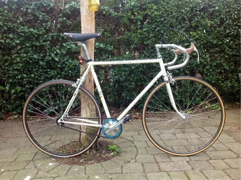

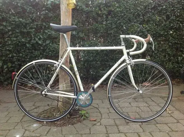

It continues to take shape, slowly.
I will let you all play spot the difference!

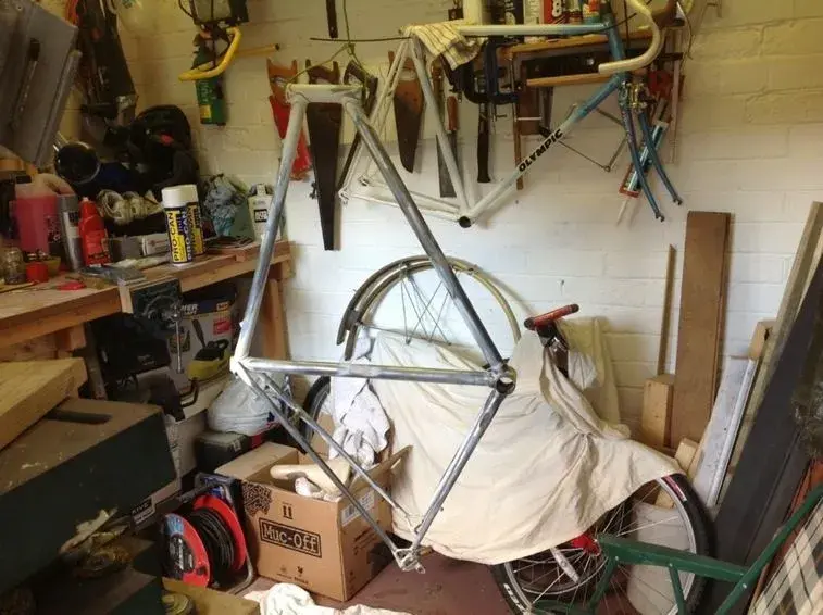

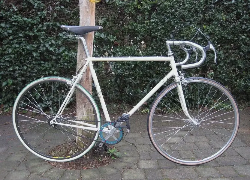

Further updates, brake hoods, super record pista front wheel with GP4 rim etc

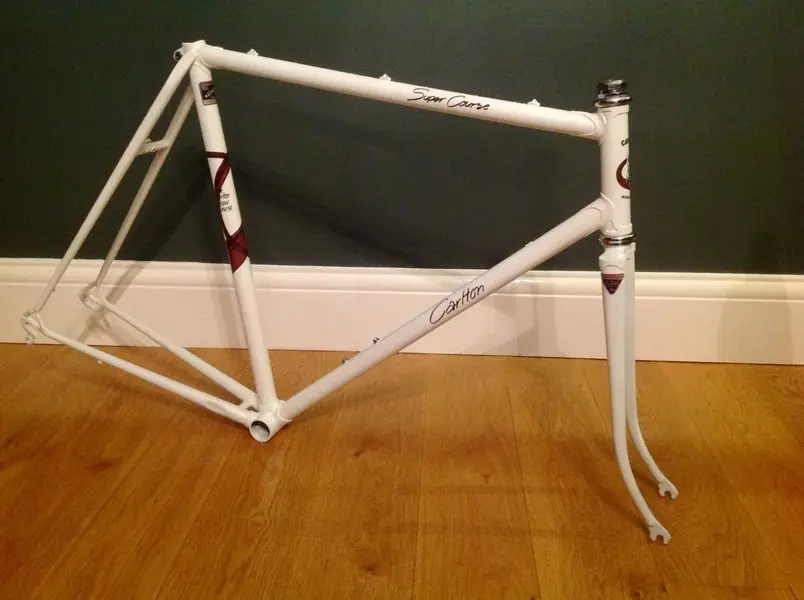

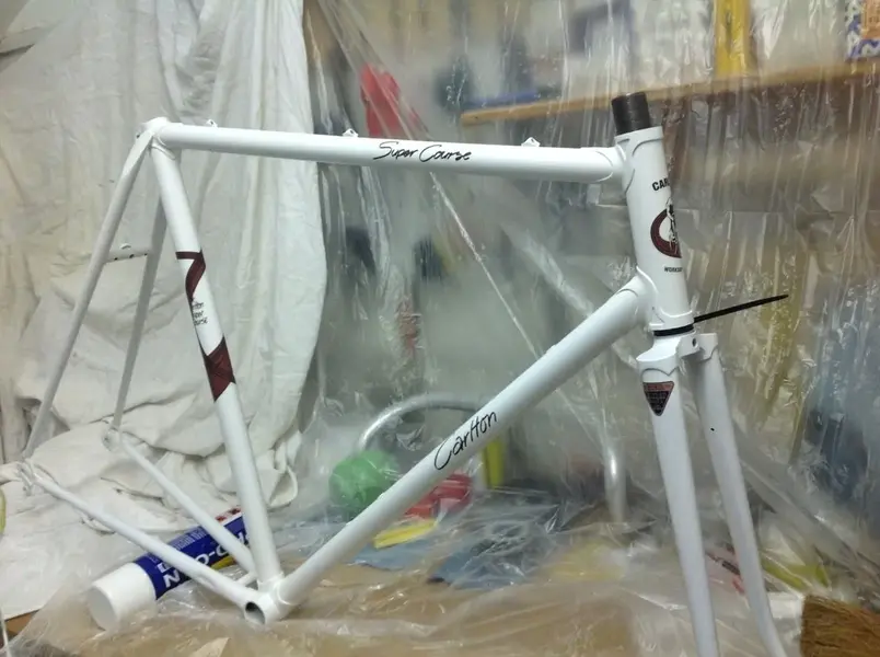

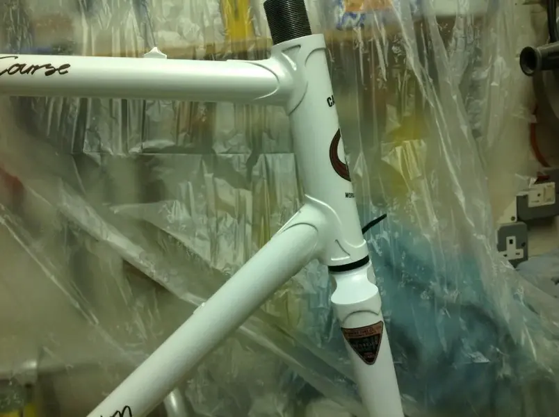

Slight update.
I decided that the Carlton really deserved to be restored rather than being left as a rat bike... So...
The dent was removed by ramming a super long seat stem down the seat tube and then rolling the outside of the tube with a tube clamp and finally skimming off with a little filler.
The respray has begun and the new Carlton Transfers are on order...

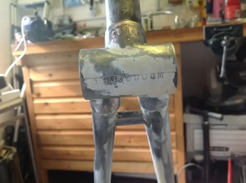

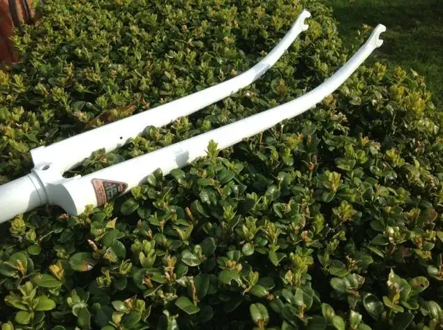

The frame is now in primer but the forks are done!

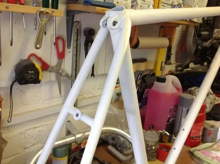

Lots of rattle cans later and....
