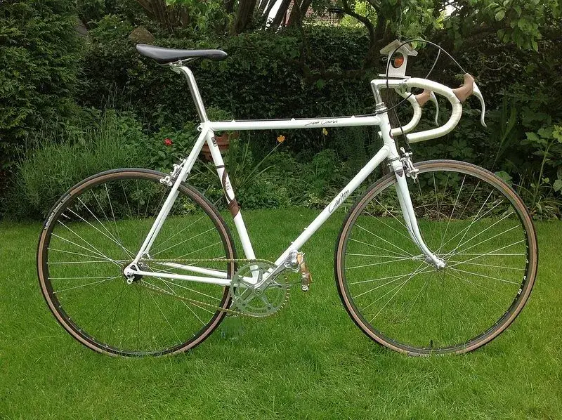

How's your OLN and chainline Theoldfm? Have you had to make any adjustments in that area? Is that a freewheel?
I have no idea what an OLN is but the chain line is fine. The rear wheel is dished over a bit though which helps.
Yes, that is a freewheel!
When I asked about OLN I was asking about the distance between the inside faces of your rear dropouts, or the Outside faces of your LockNuts. Think of how much unnecessary keyboard-work I've saved myself by typing: 'OLN' instead of: 'the distance between the inside faces of your rear dropouts, or the Outside faces of your LockNuts' ... :? :)
Looks like you've got axle-spacers on the non-drive-side. Did you swap over the drive-side and non-drive-side spokes in the hub?

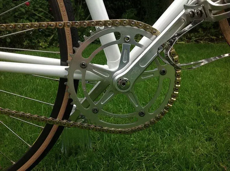

I think it is finished now. New chainring and crank bolts fitted. What now? :?

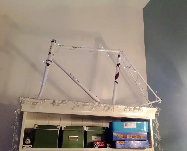

I really must get around to doing something with this frame... Either sell or re-rebuild...?
