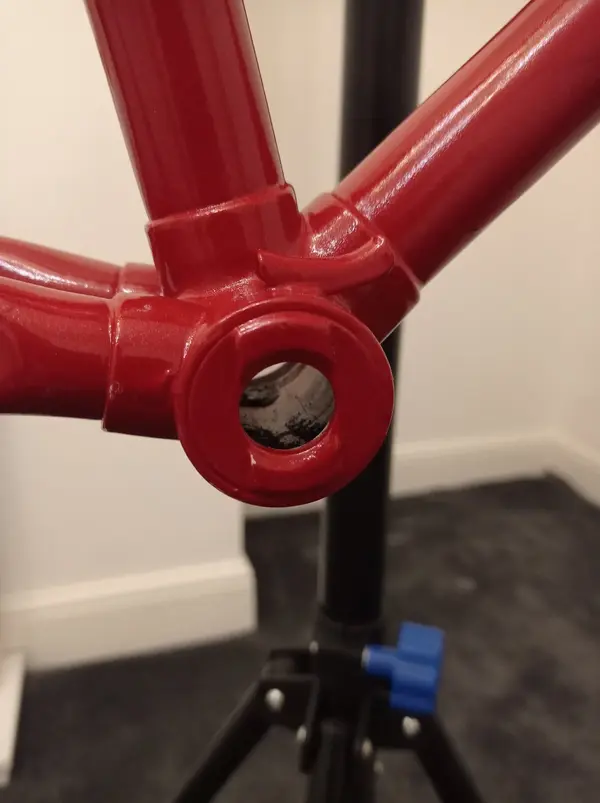

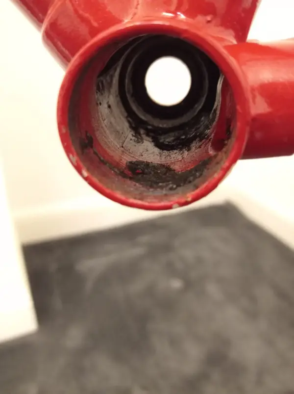

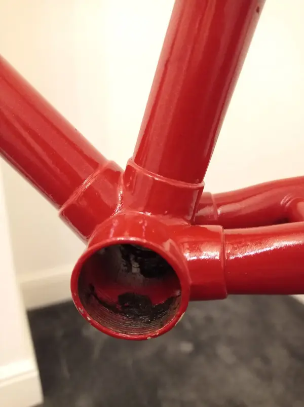

Follow up on my earlier thread. Thanks for the replies. Trying to source a bottom bracket for my old Carlton frame. The BB shell is in pretty good condition so hopefully will be ok to fit a new mechanism. Although I've heard people have had some issues with this and the thread can be damaged easily. Any recommends/advice would be appreciated.
There is some strange black glue/gunk in the shell which i will need to clean out with something not too corrosive.
Added some images

Your frame appears to have a Raleigh R/H bracket cup, which would be Left Hand Thread and 26 threads per inch. It would probably need a tool that bolts through the bottom bracket and at least 2 feet of leverage to remove it. The head set may also be 26 threads per inch (Raleigh standard)
As the frame is from a fairly low end bike if you are looking to build it as near to original as possible it would be economically better to find a correct spec complete bike, and use the parts to build yours.
Keith
