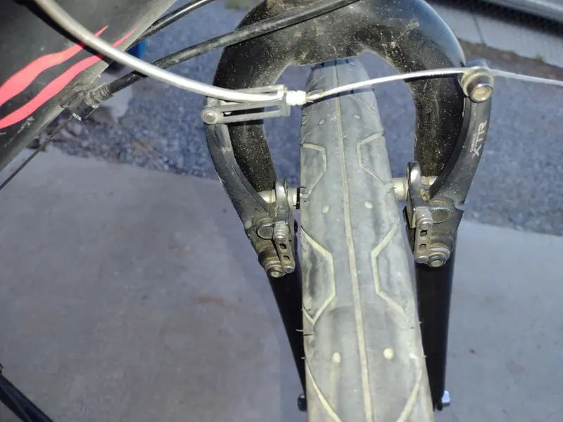

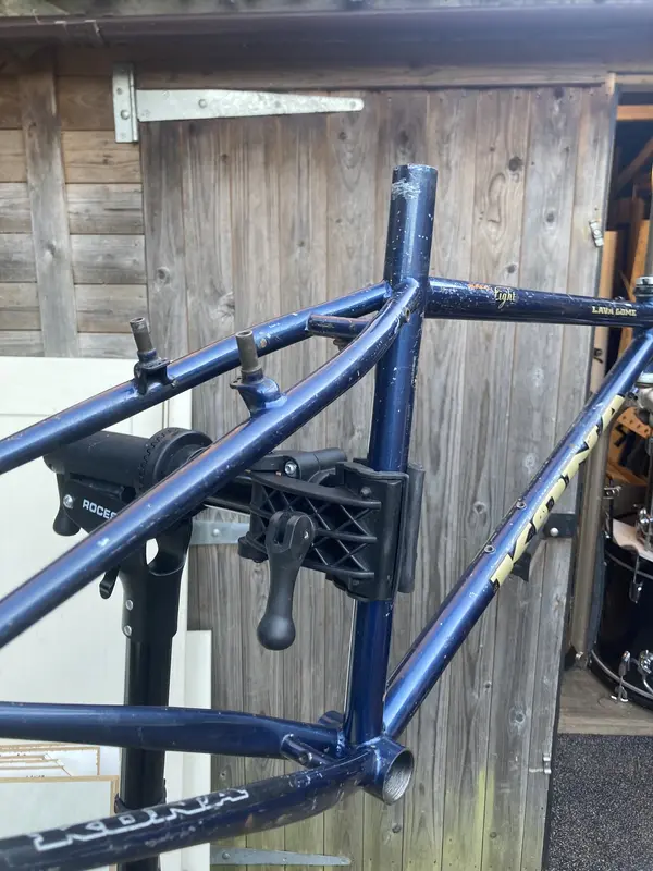

What are the most common ways to adapt a frame meant for cantis to take V brakes? I have a Problem Sovlers clamp on cable stop on one of my bikes but they are quite expensive and don't look that great. Was wondering if there's a more elegant solution to be had.
I have seen the bolt on the Kona dog collar replaced with a cable adjuster and turned 90 degrees. The brake cable outer then sits in the ‘head’ of the cable adjuster. Not done it myself though.
