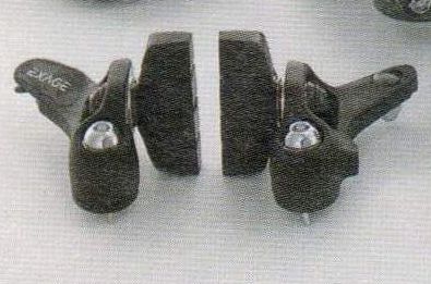

I'm trying to find some suitable replacements for some circa 1990 LX M550 and Exage canti brakes as shown in these catalogue scans:
The problem I'm finding is that the original pads are very deep which allows them to easily reach the rim braking surface.
However any replacements I have tried so far lack the necessary pad depth. What happens is that the pads don't reach unless I severely compromise the cable angles and set-up.
What I need is some pads where there is a bolt which threads into the back of the pad. That way I can use longer bolts along with spacer washers to get the correct set-up.
All I have found so far is pads which have a short threaded stud on the back onto which a nut is threaded.
These are always too short.
