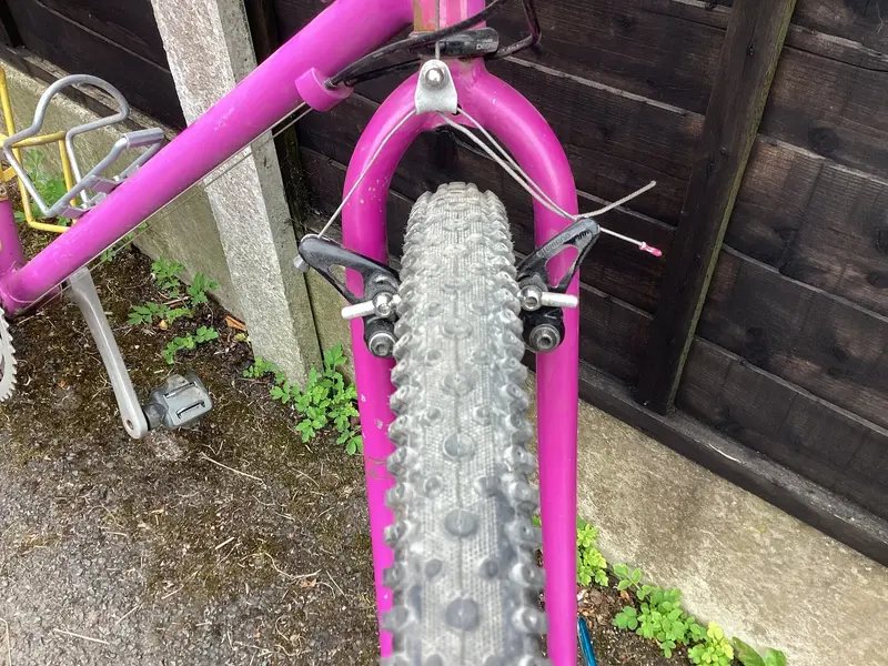

I thought this thread could be a resource of advice and tips. God knows I need them; others might benefit as well. Here is what we’re starting with. The front:

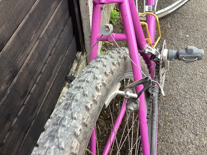

And the rear:
Different straddle arrangements. I remember having the rear set up previously. I always wanted those CND style hangers but couldn’t afford them. Haven’t seen them in a while.

That rear doesn't look like it likes the wide profile setup,. With the normal blocks, the blocks are near tight up against the block head, ( low profile are the opposite), is this the tyre rubbing one, I've forgotten and on mobile so looking backs a pain

.Looking at the rear
Get a new cable when you can, you can see twists and bends and flat clamped parts
Move the fix length down a notch.

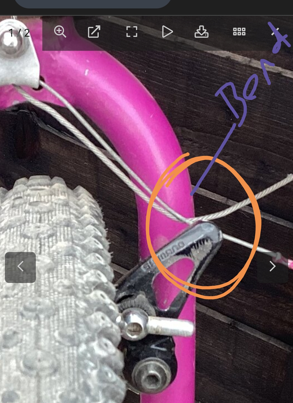

You can see the brake is at the wrong angle as it's bending the head.
Clamp the pads further in.
XC Pro have a return spring in the lever, iirc. But I would try it in the normal position at the back of the canti.
Clean everything.
You can always try a low tension later for a better light usage
Front
Avoid this, it's subtle, but keep at as straight as possible when it goes in.

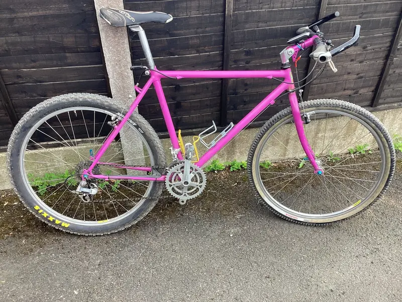

The bike is a Saracen:
Which at this vintage used full length internal outers for the rear brake. Ignore the rear tyre, something more suitable (and narrow) is on order. XC Pro levers @legrandefromage
