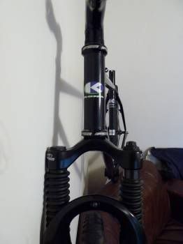

Here's the set-up. Thanks for the offer jamabikes but I've got one of the bolt on hangers, I guess it would attach to the fork arch? Think I'd prefer to use one of the stem jobbies. Are you selling any other bits n pieces? That charity's a brilliant idea!
As for the rear, I can't bloody find the original Kona seat post cable guide so may have to think again :x
It'll have to be the bolt on one for the fork I'm afraid. If you use one at stem level, the length of exposed inner will change as your suspension fork compresses/extends, effectively operating the brake for you!
