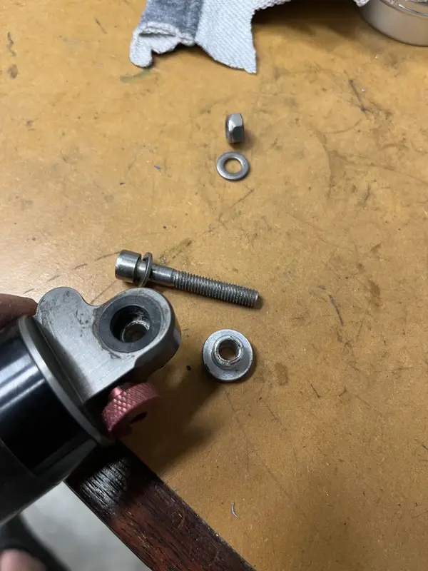

Hi all - last week i picked up a v1000 in good working condition from outside someones house for free ( i did ask them ) ive stripped the bike to frame only & the only problem is the bush on rear shock ( fox ) that connects the shock to the front of the frame ( not the one that connects the shock to the swing arm ) has perished . Does anyone have details of where i can get one or anyone DIY made one ?

Hey Fatboy, cheers for your response mate. These aren't your usual DU bushing. There is an elastomer type plastic bushing that pushes directly into the shock eyelet, and the alu spacers/hardware presses straight into it. Might be a case of sourcing the material, and fabricating my own.
