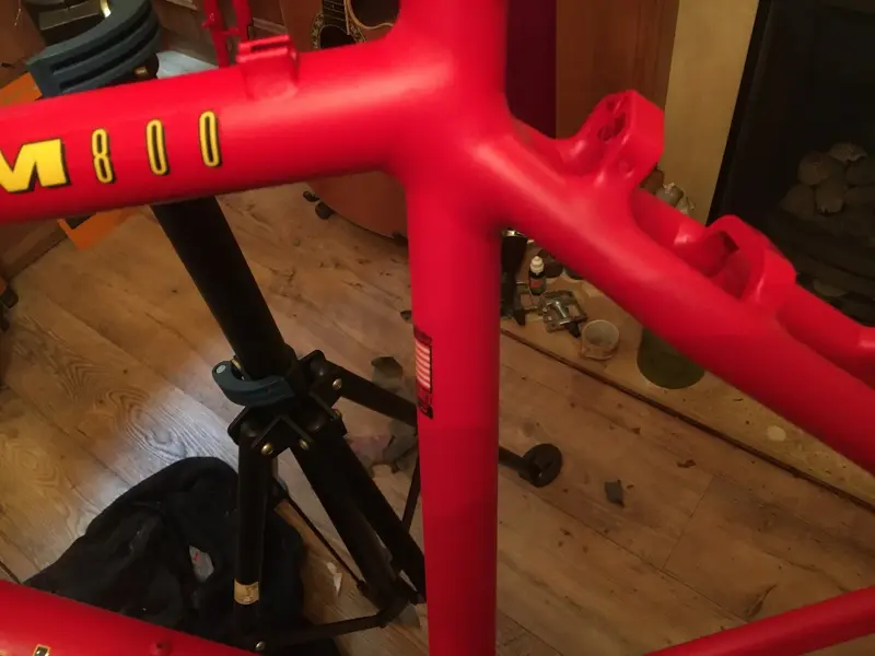

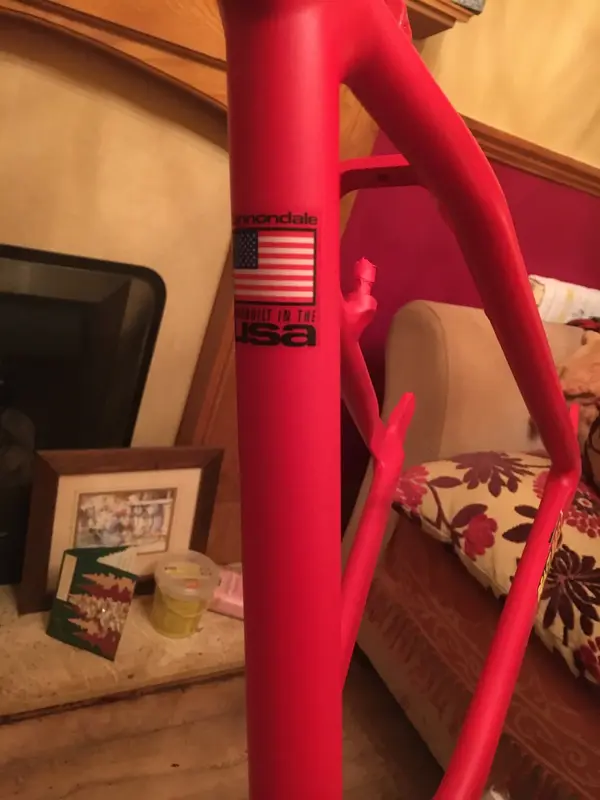

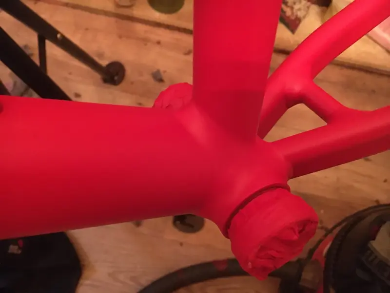

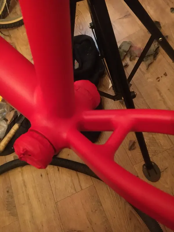

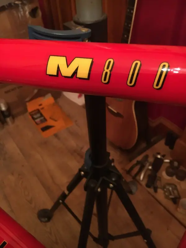

Ok base the coat on the frame is completed, however am having a "lacquer" debate with myself, more to follow on that! I carefully masked off the original decals and the "faint" line around the decals will blend in with the several top lacquer coats. Hopefully!
I have fired in an old external BB to protect the threads from over spray.

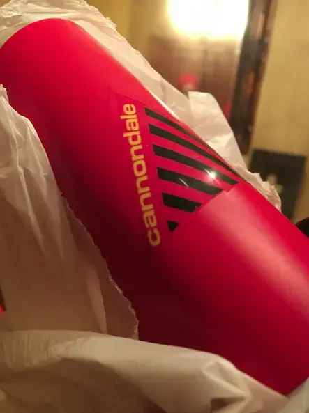

Hopefully I can blend in the head tube decal with 3000 grit - and the new top coats of lacquer will "fade" it in okies!

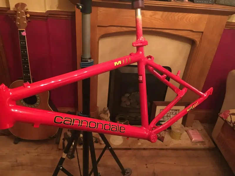

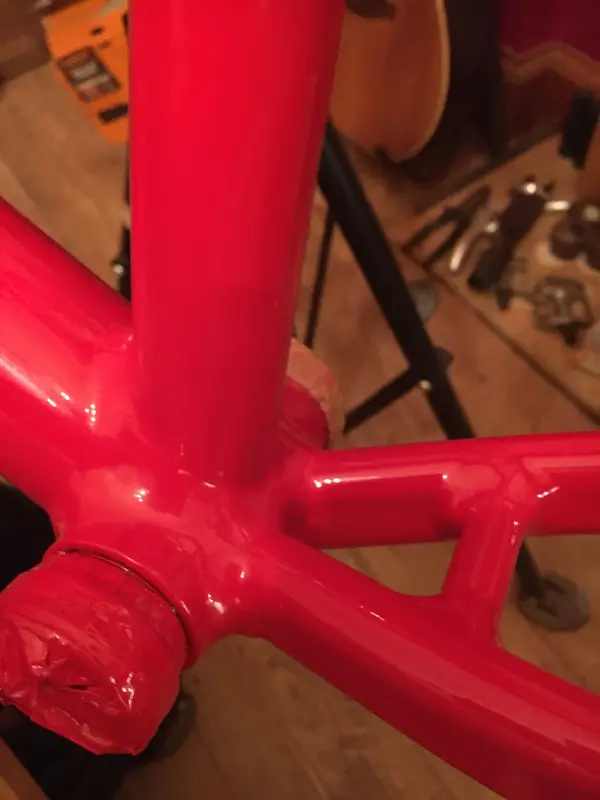

Okey, getting there slowly. Frame with 2K lacquer. I need to touch up the fork, and finish the F&F off - but am getting there with a lot of 3000 grit Wet n' Dry etc etc. I have re-painted the complete frame with the original base coat colour, keeping the original decal stickers, masking them off, then 2K lacquer. More to follow soon.
