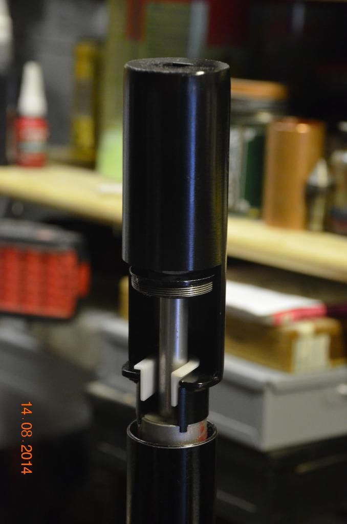

I have serviced a couple this summer. I think there is a good chance yours will be the same as this below. Sounds like you have an oil leak in there. That vintage of damper should be oil and air. There is a small return spring which is not shown in my photographs below. I have some other pictures I will post up later in the week.

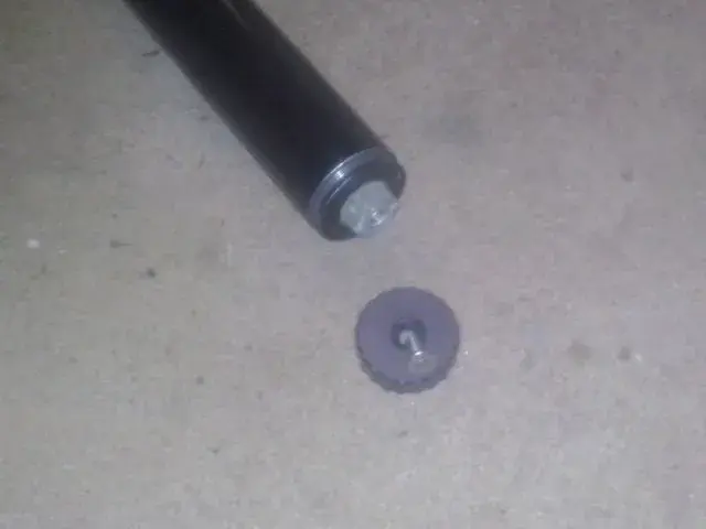

Looks similar. I have discovered the top cap is lock out and held by a countersunk m6 screw, both removed.
There is a large nut that is turned by the cap that ive not been able to remove - is this pressed onto to thr shaft?
Unscrrwimg the nut unscrews the top cap from the steerer tube to expose the slotted aluminium cap. It looks like i need to remove that.
At this moment, i do not see what holds the damper to the forks, from below i see an air valve, i would have expected a nut or similar holding the dampwe in place.

Not sure from your description of what you have done, if you have unscrewed the cap fitted into top of steerer tube by using the nut that the lockout dial/cap is fitted to, you might have damaged the lockout inside damper. It is only supposed to be turned through around 90' to operate lockout and SHOULD NOT BE FORCED further. The cap screwed into top of steerer should have either 2 or 4 holes in it so the you can use a Park pin tool to unscrew it. Although in your OP you do mention the top cap the size and shape of a Shimano external BB so you might have just unscrewed that, hopefully.

This is where i am at. Looks like i need to make the pronged tool to remove the top of the damper and leave the nut alone. As you can see i am able to remove the threaded top cap from the steerer.

Are you sure that is the same Headshok as yours that looks like a different one to me. I have created a post with the images from one of the one I was working on over the summer. Both forks I was working on are from around 2002-2003'ish.
Please read up on the subject because it would be a shame to waste a perfectly serviceable fork by not spending some time doing some research.
http://www.retrobike.co.uk/forum/viewto ... p;t=311689
