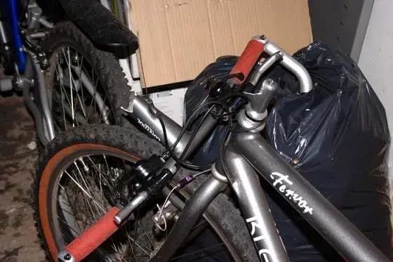

Actually that's not entirely true. The forces that the threadless stem clamp and the end of the steerer tube see are comparable to the forces experienced by the point on the threaded stem where the extension begins, not the quill at all. On a hard landing, for example, shearing forces forward have little effect on the quill, but rather are focused on the base of the stem extension. Pic (from this board) is attached which demonstrates that shear failure of a stem. I wouldn't use a threaded steerer tube with threadless unless I had not other option, and then only if the lower edge of the stem was clamped on non-threaded tube and the threading begain inside the stem stack height.
When in doubt tho, as with all things, just say no. :D
