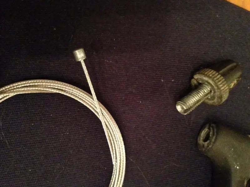

Can you use gear cables as brake cables ?
Bryncrug72
Trying to come up with a way of converting a lever to pull two cables, the nipple on a gear cable is smaller than the pear shaped (road) brake cable, would the nipple on the gear cable take the stress of braking ?
I wouoldn't risk it - they way differ by a little in diameter but think of cross-section whcih is related to diameter squared. I've had 2 brake cables snap on me ...,
