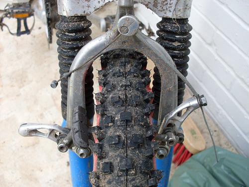

I'd just like to return to the difficulty I have when removing the wheels.
It's occurred to me that when I unhook the cantilever straddle wire, only one of the cantilevers gets out of the way of the wheel...
Wouldn't it be easier for me if I got rid of this Shimano arrangement and just replaced it with a simple yoke hanger like this one?

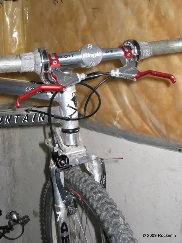

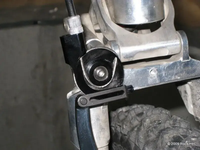

v-brake release allows for both arms to be pushed out of the way. Here are shots of my setup:

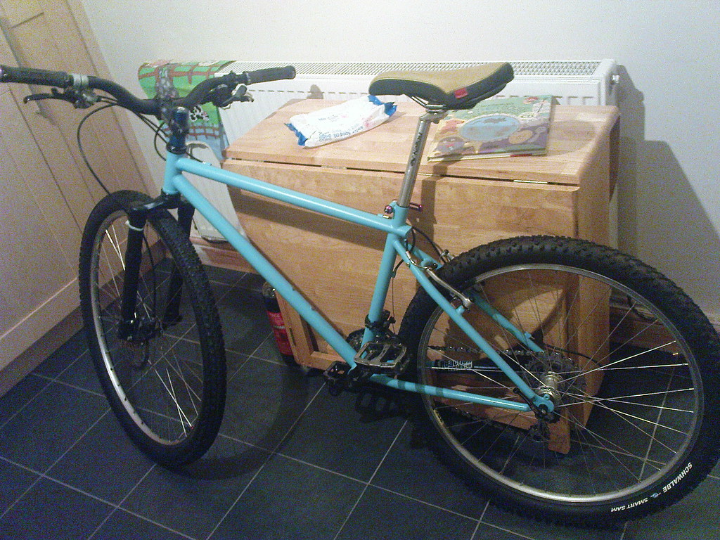

Here are some close ups as promissed of my bankrupt Saracen frame.
Before and after
End result
Some heat shrink (available from B&Q) added to keep the mud out. Be carefull of the paint. My thin layer of rattle can paint wasn't able to cope. Next job strip down and powder coat.
Matt, thanks for taking the time to upload these. That heat shrink is an excellent idea. Pity that your paint couldn't hold on thru the noodle-bending process... :( ;)
