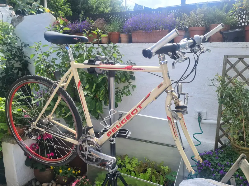

I am modifying a Campag triple chainset to use just the inner (granny) chainring, so I'm hoping the chain line will be fine with that.

I have a Campag Chorus screw on hub now, so let's see what happens next...
8 Speed chains are designed to run offset all the time. 8-11s chainrings can all run it. Most freewheels too. A little care choosing your parts should make it easy.
