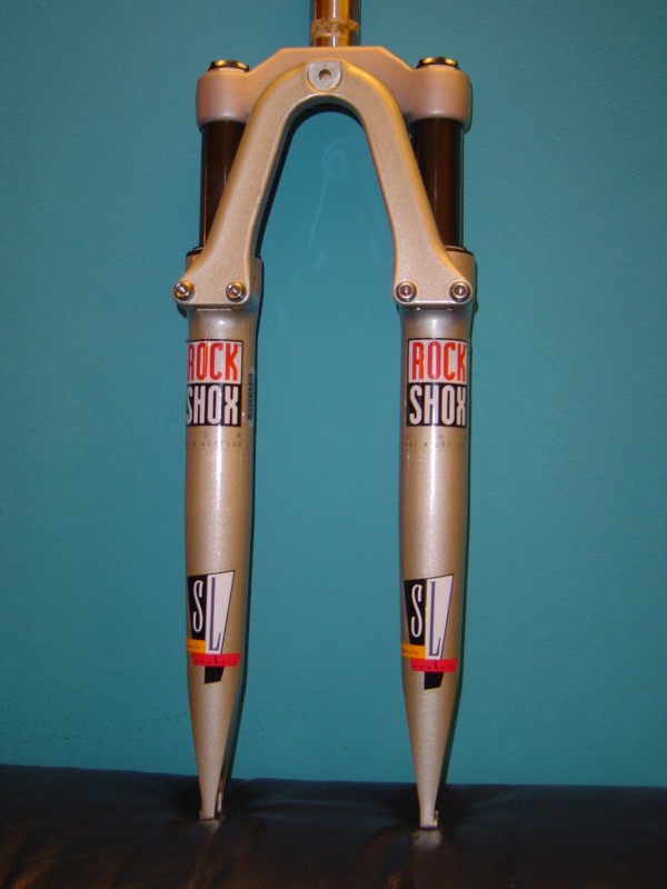

Its unchanged from the box..so whats with that crown? Any pictures how it's supposed to be?
FluffyChicken":2o6ru26u said:
That crown doesn't look like it's the original one though, doe not look like what I would expect an SL crown/steerer to be
Looking at the pics I have found, reetegoed's crown is more straight edged compared to the originals which are 'flowing' and smooth ala 20/21's.
Odd :?
It shouldn't have the 'ring' under the crown. that is reminiscent of a 1993 style crown. Also the steerer tube should be Alu. It should look like the 1994+ style and more than likely is the SL crown so polished.
I will also mention the forks are either flat (no air in them) and probably fully compressed. If not something is wrong ;)
There was an early model I assume test version in 1992/3 probably, but I think they where based on the MAG20 styling and flat crown and looked a bit naff. I don't think they were released to market until 94 or possibly 95 ?
See the lovely shiny crown and Alu steerer* all the bolts should bt Titanium as well.
*unless it's threaded of course, it would need to be steel or the Ti one then and I presume you would see the external butting in the tube.
I also think they only came in 1" size.
Note: remember I have never seen one of these though.

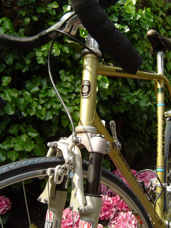

You guys see things I would never have mentioned :shock: The Mag 21 that I bought in 1994 had a relacement for the smaller 1 1/8 crown inside the box. This SL has a 1 1/8 steel treaded tube. Here some pictures from it installed on my Koga
I am going to remove the fork from the Koga and transform it into a mag suitable for of road.
