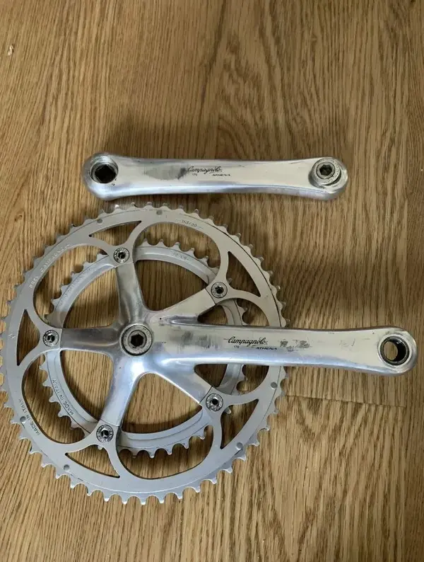

Photo 1 which looks like it will fit the BB but will this be compatible with an 11 spd groupset

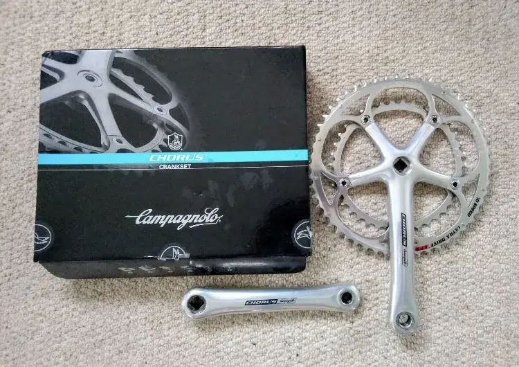

Alternatively there is a photo 2 but does this require removal of the square taper BB?

in photo 1, if they're 10 speed rings (lokos like they're not), then yes they will work with 11 speed. and will fit square taper, but check the length required and the length of the one installed
in photo 2, those will definitely fit 11 speed, but need an external BB, so the square taper one fitted must be removed

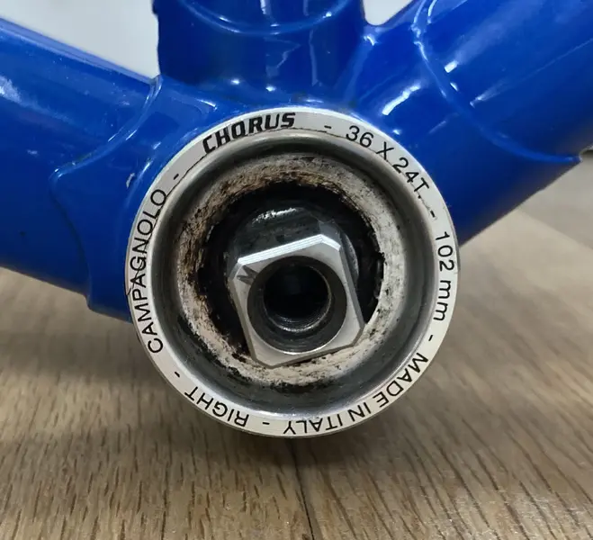

The bottom bracket fitted in your frame looks to be either Chorus or Record and the axle length will be 102mm. If you look on the drive side cup it should be written on the outside along with the type of threading (1.37x24 or 36x24). This means that the bottom bracket will only be compatible with either a Chorus or Record chainset because of the 102mm axle length. To fit the Athena chainset in photo 1 would require a bottom bracket with an axle length of 111mm.
As foz rightly says above, the chainset in photo 2 will need the square taper bottom bracket removing and Campagnolo Ultra torque bottom bracket cups fitting.

The BB is just as you said:
So a 10 speed chorus chainset like this would fit on the BB

I'm confused as to why they have different bottom bracket lengths and which types of campy groupsets are compatible with which. Am I right in thinking that older chorus groupsets are not compatible with the BB I have? so am I restricted to only 10spd groupsets?
Just wary of looking for components and making sure they work together correctly
9 and 10 speed Chorus and Record take the short 102mm BB. (1996 onwards roughly), the others (Mirage, Veloce, Daytona, Centaur) take 110mm. There are three different crank forgings, hence the different BB lengths. The forging for Mirage, Veloce, Daytona, Centaur is common, the difference being in finish and rings. Chorus has its own, initially 5-arm but used the Record forging (with 5th bolt hidden beind the crank) in later years.
