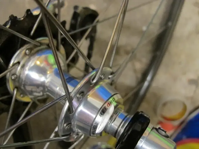

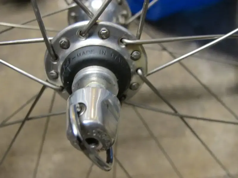

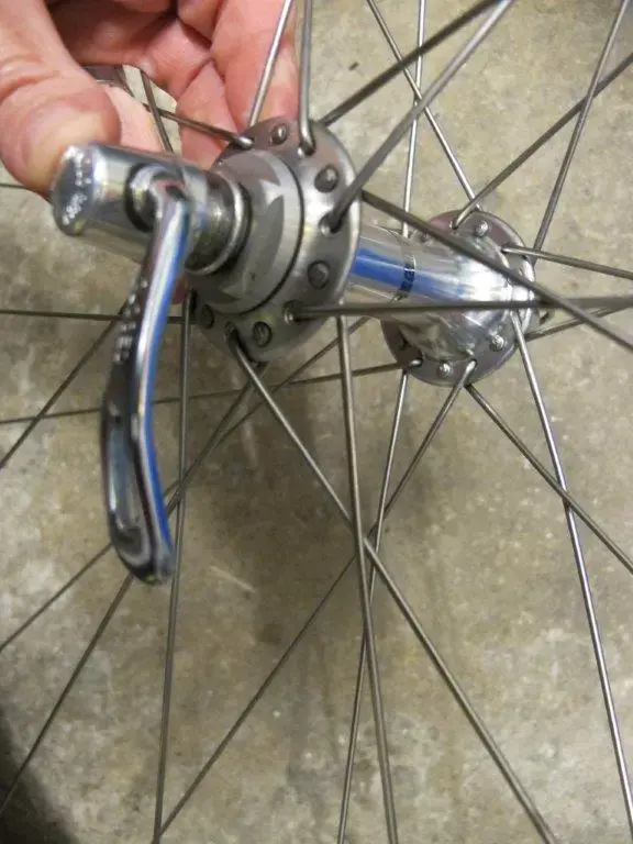

These are mine, they are on a bike my Dad left me. They have done less than 3000 miles and they are the best hubs I have ever owned, no doubt. You cannot feel a thing when the wheels are removed and spun when held. Awesone.
I am considering upgrading to Campagnolo Bullets at Christmas, but I bet the hubs aren't a match.
Thanks for all the replies.
Matt
