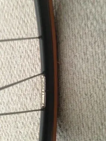

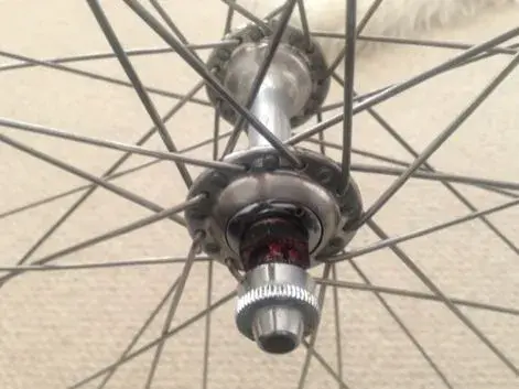

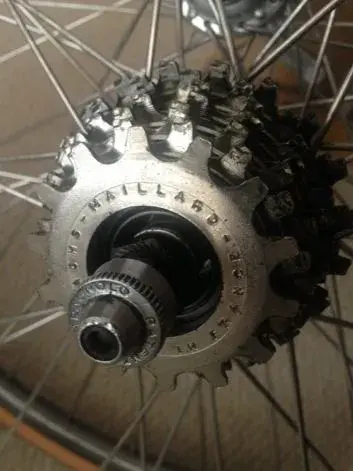

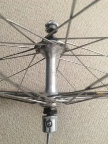

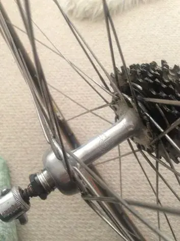

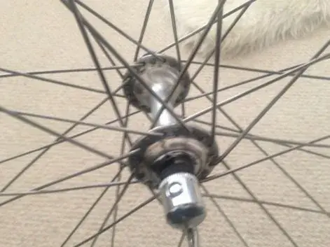

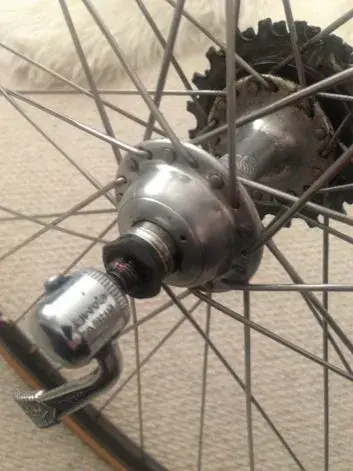

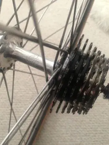

Hello,
Picked up a road bike recently and it has a very mixed groupset; the wheels are Wolber TX Profil with Campy hubs.
Year is, I believe, 1990 or earlier.
Screw on freewheel (English thread), 36h, logos are etched on, slightly domed, more shiney bearing cover with a small hole in.
QR's don't match each other exactly.
No real urgency on this... I'm a road novice and would appreciate of you could give me any hints as the the Groupset these originate from.
Many thanks
Mat

Re: Campagnolo Hub ID - Help Please
Yes, these are Tipo hubs and very nice they are too. They usually formed part of the Gran Sport group from 70's to early 80's
That's them! Thanks both, really appreciate your help. Glad to hear that these are quality items.
So mid-80's at the latest. I thought they might be a bit later as the rims are deep profile Wolber, though this sticker design does look an early vintage compared to most I can find on these rims.
Cheers
I remember reading the manufacture date was printed on the inside locknut face of Campag hubs , i guess that only refers to the locknuts anyway ... but being 7 speed they must be 126mm , which hints late 80s to me
We sold these in the 70's as well at 126mm OLD. Curved QR, knurled nut, circlip holding lever and no oil hole :)
The large flange had circular holes and not the NR oval holes. Happy days :D
