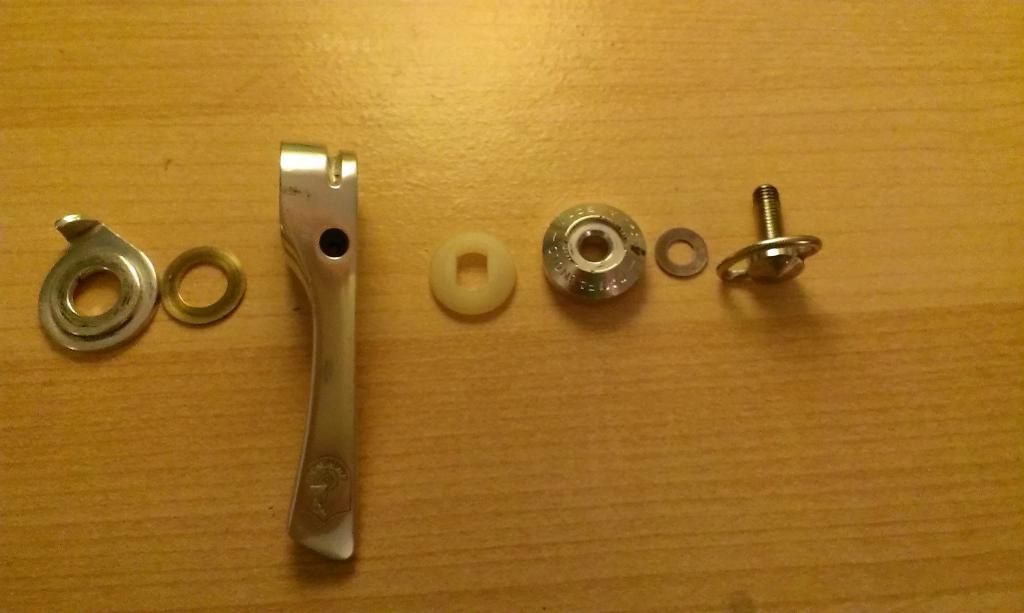

Some time ago bought a set of Chorus friction shifters and when installing them I've run into a problem - the shifters do not mount tightly on the downtube bosses. I think i have the wrong internals, there certainly a few pieces missing compared to other images I've seen on the web. Here's what I have :
Here's an image from online. I don't have parts f, g or h. Part E is engraved campagnolo on mine, I think I may even have parts from older super /nouvo record shifters.
Anyone got any experience of these?
thanks
C-Record, yes. I bought some from Campyoldy (for about £40) and used the guide that you have shown, so unfortunately it looks like you have some pieces missing.
Your E could well be H??
Good luck
Matt
Thanks.Have done some more digging and turns out there were two assembly versions shown on the campagnolo tech sheet. not sure why but mine are complete. It was actually some old loctite on the threads stopping the bolt going fully into the braze on .
