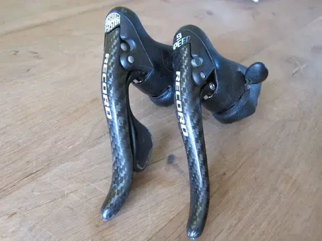

Apparently they're approx 1999 (according to the guy I bought them from) but labelled 9 speed? Here they are.
No, they are 2001 or later, assuming they are not some kind of frankenstein of a later body. 1999 Record did have carbon blades as an option IIRC, but not the speeds on the body:
What was your rear mech like? Did it have the big knuckle by the top jockey with no B-tension screw (2001 or later)?

My Record levers were pristine condition until yesterday - they've taken a fair scraping along the Tarmac. They still click nicely though.
