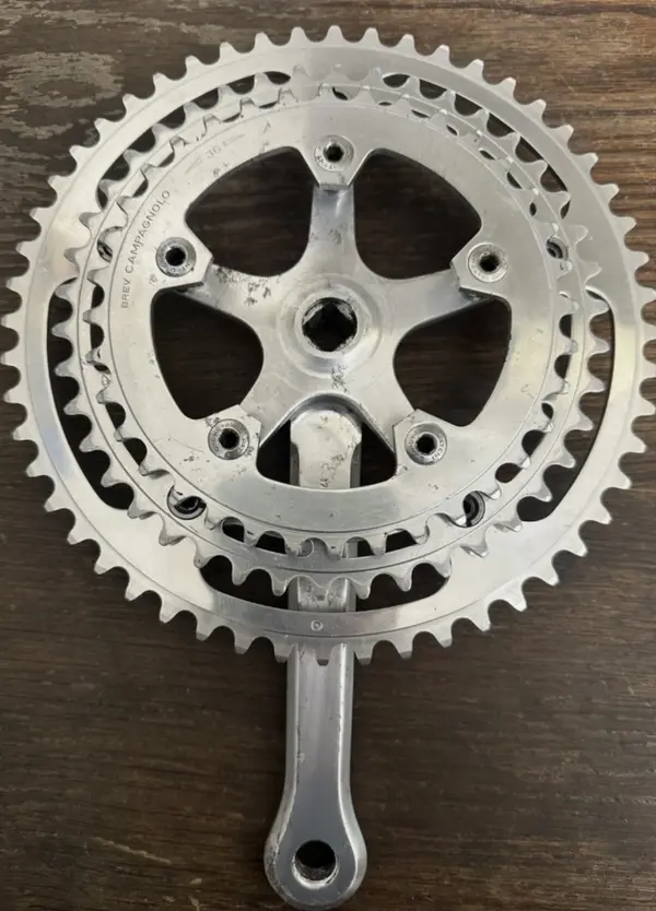

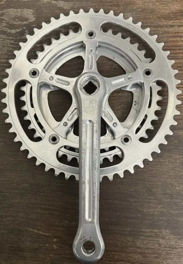

You could probably make one like the NR by drilling and tapping the arms and adding spacers for the smaller inner chain ring. I believe when people first did this to the NR it was just done by people that knew a machinist and had them do it. I'm pretty sure it would be fine as there's more meat to the arms than a NR crankset. I bet it would look sweet.
The more modern shape might not be very flat, which could present complex requirements for the tapping and spacers.
