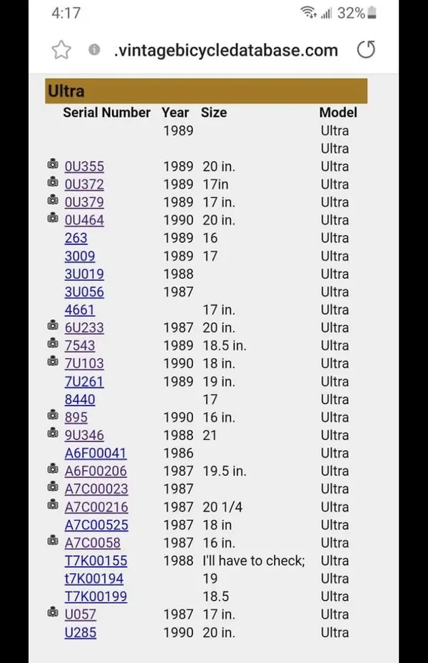

The frame number is 0U398, which based on the frame number advice (see image) would make it a 20 inch from 1989 but its not a perfect match.

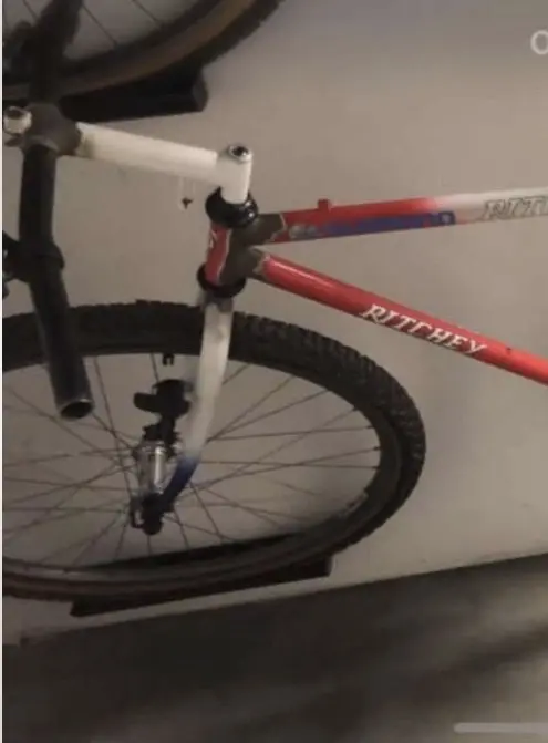

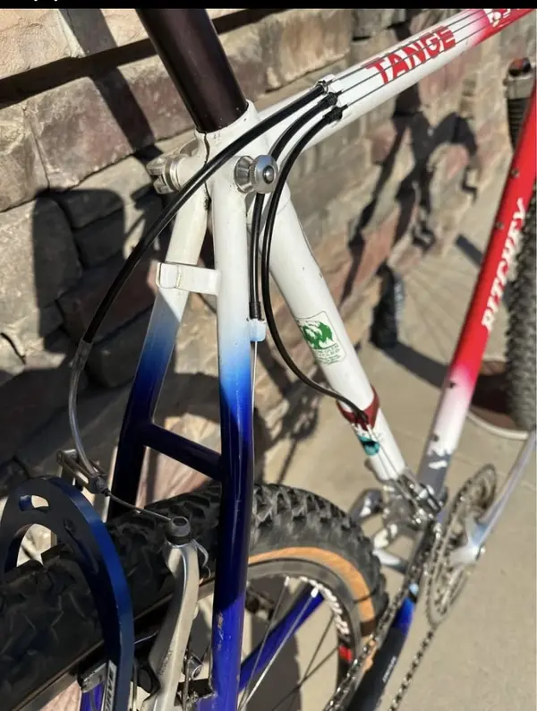

There is a similar frame that has appeared on Facebook recently (see the photos at the end) which looks very similar colours, decals and cable routing.

Thanks for the reply. Some good advice there. I think it’s an Ultra too but was the cable routing different?
So here is the link to my 80's Ultra. Its T7K00194 in the vintage Ritchey database. I'm not sure what the T7K signifies - possibly Japanese construction.
https://www.retrobike.co.uk/threads/scabby-ritchey-ultra-dirt-drop-build.446415/
Some similarities with your bike, but mine has a UII rear brake and different cable routing although I have seen examples of about the same vintage with cantis in the back.
*Updated to note the serial number information from the Ritchey site*
"TIG Welded Frames
These frames follow the scheme: LNLNNNN or NLNNNN
where N=number and L=letter, and the trailing numbers can be 4 or 5 digits
Examples: 5L00079, 6D00168, A8C00071
These serial numbers provide less information. The first digit (above: 5, 6, and 8) are the year the frame was built (above: 1985, 1986, and 1988). The letter after the year is very likely the month of manufacture, with A = January and L = December. So, "5L" is December, 1985. The remaining digits are the build order, apparently for the year and likely for all Ritchey TIGed frames.
The leading letter, most often/always an "A," is not on the all of the frames. I'm unsure what is means."
So based on that I would guess my frame was the 194th frame made in November of 1997. No idea what the T means. Elsewhere on the site he suggests that T could stand for Tom in the road bike serial number discussion. If he fillet brazed the rear triangle that could make sense. Anyhow the U in your suggests an Ultra. Its possible that someone took an Ultra to a builder, had the cable stops changed and then repainted it in team colours as an upgrade. You probably wouldn't know for sure about that unless you remove the current paint. Other thoughts is to weigh the bare frame and compare to an Ultra - the P series should be lighter. Since they used different tube sets could there also be a difference in seat post diameter that could be an easy check?
