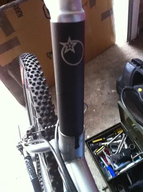

Little help woul be much appreciated :oops: Here is my son's bike (build in progress :P ), what's the exact size of the seatpost (still slightly turning in the seat tube) :?:
That's the 97 in forward-facing slot flavour, for which Orange fitted a 27.2 post with a 27.2 to 29.6 shim.
Judging from the distortion, the post you're using is too small.
Anthony":cvonhsuq said:

I've just check, it's the right seatpost (USE in 27.2 diameter), but wrong shim, it's a 29.4 :oops:
kiwideturin":1olkasdv said:

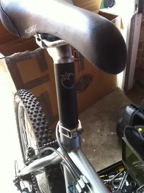

Well 29.8 fits perfect, I've got a NOS Orange 29.8 Seatpost in Black and it fits perfect into my C16R should I wish to ditch the shim and original seatpost ? Will get my Vernier Calipers out and double check tomorow.
Ok, spent this evening with my 1996/97 Orange C16R, Removed Original Seatpost & Shim to confirm size.
Original Seatpost = 26.4
Fitted NOS Orange Seatpost without Shim = 29.8
Clamp re-fitted and perfect fit all round :D
Hopefully that should solve the Seatpost issue, I'm guessing the Tech Spec on Orange's website is incorrect but the information in the catalogue is spot on correct.
