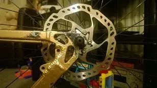

:D hi just asking if anyone has come across getting a post mount or caliper for a 43mm centre to centre disc mount or converted a 51mm drilling holes for a hardtail thanks :?:
Formula did a 49mm standard, never seen a 43 one. Can you post up a picture?
centre to centre def 43mm could say 42mm but i have seen reviews about thiss size caliper been told hope did one hope c2 whether thats ture i,m not sure cant find any specs on centre to centre pix thanks
Think u require a no 1 caliper same as they used on the 22mm mounts ( they had an adapter )
Can only run a 165 disc though
:) ok no 1 hope caliper with the adaptor ???sorry trying to get me head around this where would i get a adaptor think i seen a caliper on the bay but 43mm i seen a trek/fisher adaptor but not sure if it would fit help lol!!!
ok c2 even better c2 disc i,m only seeing 5 points on the disc to hub is that a problem to fit on a 6 holes :?:
Most c2 discs were hopes non-standard 5 bolt fitting, however you can get both hope and after market discs in 145,165,185 and 205 that will fit c2 calipers and ISO 6 bolt hubs.
