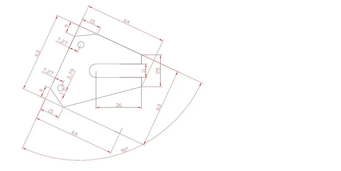

Registered mainly for this thread. I have a Cadex which I was thinking of doing the exact same thing with. Would the OP be able to post some higher rez versions of his fork end drawings? Or PM me? b
I have PMed you a 1:1 pdf of the drop out - I would get the dropouts made without the holes being drilled for the bolts though. Then make sure the dropouts are a snug fit in the frame and then use the frame as a drilling jig to drill and tapp the holes for the CS bolts.
Legend! Thanks mate. Too much of a noob to leave you +ive feedback, but consider yourself positively repped! b

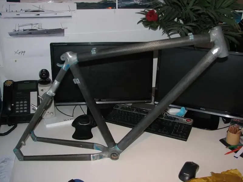

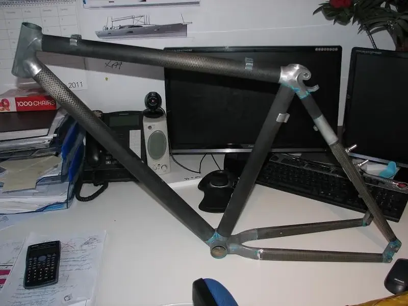

Quick update here - decided to sand the frame and go for a stelth clearcoat finish. All of the lugs cable guides ect will be black.
Off to the painters NOW!
