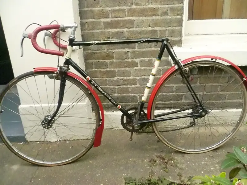

That is tidy and incredibly un-messed with for such an old bike. Certainly the frame and original paintwork is much better than mine. Looks like the front tyre could be original fitment? just like yours was Mike. It just needs a Swallow saddle and a pair of pedals.
29 pounds 5 shillings and threepence it cost when new, according to the the Veteran Cycle Club Library. I'm not sure how that relates in today's money to the 450 pounds asking price. It seems expensive, but then I've probable spent a silly amount on mine! That happens I suppose when buying a bike one part at a time like I am..

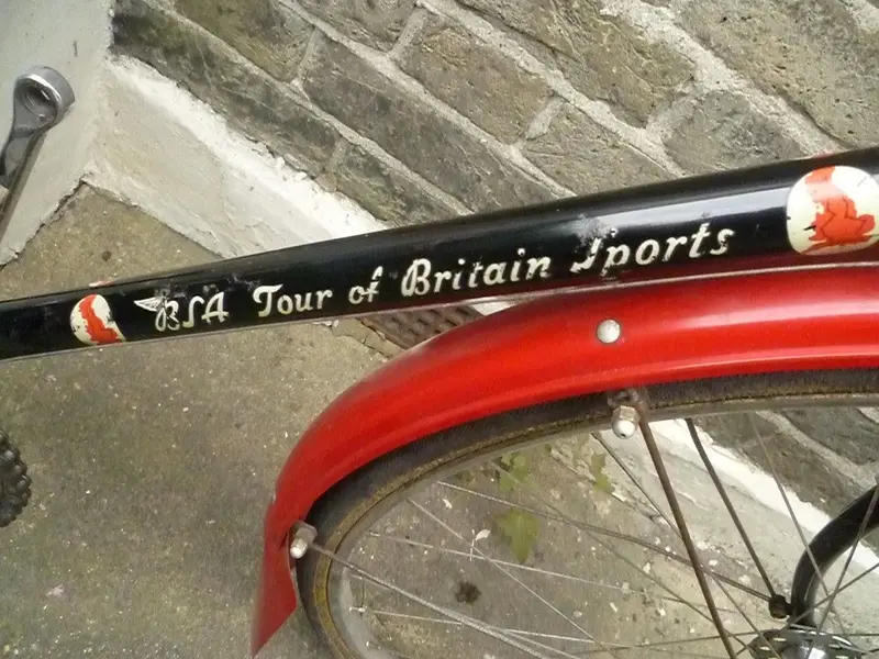

I don't think it's a BSA Small Heath made bike, but a later Raleigh version. Probably 1958-1960, after production moved to Raleigh. The giveaways are the later BSA head badge, hoop decals between the BSA letters on the seat post, The long decal on the top tube which our bike's don't have. No BSA chainset, neither would it have had BSA pedals and the headset is different to our Small Heath bikes. Oh and it's got a Mk.7 Benelux derailleur which didn't come out until 1957. Neither do I think it has BSA Continental large flange hubs, but can't really be sure from the pictures. The wheels are still 32/40 though. I guess after the Raleigh buy-out, and as BSA made components ran out, Raleigh used their normal parts and it didn't take long to lose the detailed BSA identity.
But after all my old nonesense, I still like it.
Dennis - I agree with your observations, definitely around 1958. But may I add that to me it looks like it has had a front end shunt. The forks look a little bent back, compared to the picture of Mike's bike, and that would explain why the front hub is a large flange instead of small alloy, like the back. i.e. someone fitted a different wheel, and that might also explain the broken front mudguard. Shame because the frame is in great condition, (but not £450 condition!)
I didn't notice that. Well spotted Bruce. Could it be the camera angle making it look bent?, I don't know but you'd have to pull the forks out and check for peace of mind wouldn't you. I've just looked at another pic on the listing and you may well be right.
I've also noticed the forks have differences to the BSA made bikes. The chrome fork crown covers are a different shape and the lower fork legs aren't chromed! Checking the catalogue that's how they should be. (but not bent, haha. Not funny) The bike is almost a totally different model from what BSA made. A big change in a short time.
