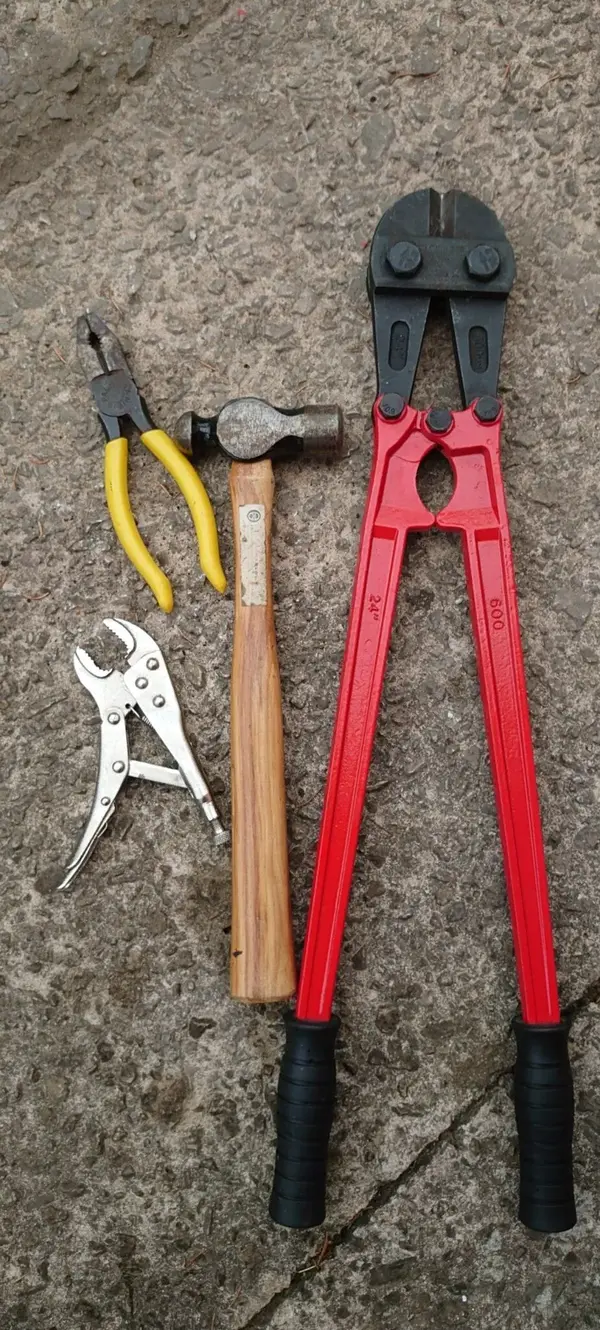

Sorted. The rusted threads may have defeated Mr Screwdriver but had no chance againd the double team of Mr Hammer and Mr Boltcutter. Threads in the casing are intact, all I need to do now it's switch it over for the bodge repaired part and see if it's any better.

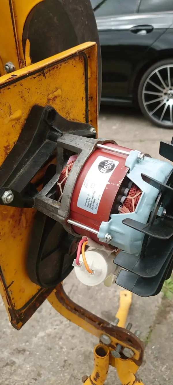

New motor, old bracket now attached and all bolted to the mixer. Seems to work fine spinning without a load in which is a good start so fingers crossed its up to the job.
