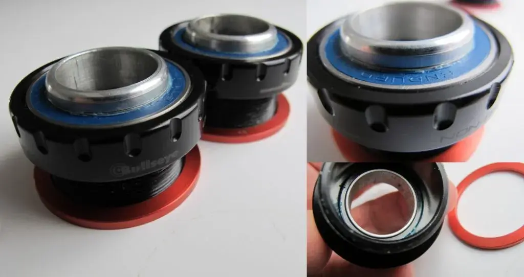

Ok, I couldn't resist it.... I phoned the guy up and bought the BB before the bid ended :oops:. Interestingly the cups are Bullseye but the bearings are Enduro MR 2437 LLB's. I've been in touch with Enduro and these are still available and they initially thought the shim/reducer were the ones they make for SRAM Truvativ BB's but they couldn't find any sales records of these to Bullseye, plus the SRAM spindle is 22mm spindle so I guess Bullseye made this as well as the cups(?).
They also pointed out that the shim has been fitted the other way around i.e. with the flange on the outside. Any ideas why? Nader any chance of some close ups?

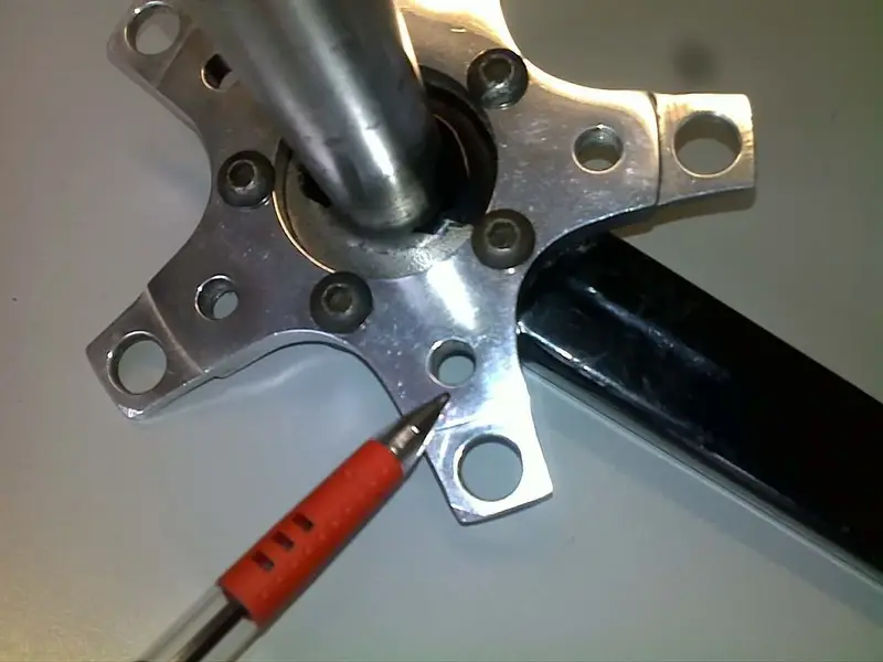

Hi Mates,
I recently bought a nice Bullseye 2nd gen. crankset complete with Bulls spider for 3 chainrings
but I need your help about bolts size on the above spider :? :? :?
two different bolts are required :
- bolts for fixing the spider on the driveside crank ( fortunately I already have )
- bolts for fixing the inner small chainring ( I need this - see below photo )
I've found a previous thread were 1/4"-28 was mentioned as bolt size but which one ??
Thank you very much to everyone :wink:
