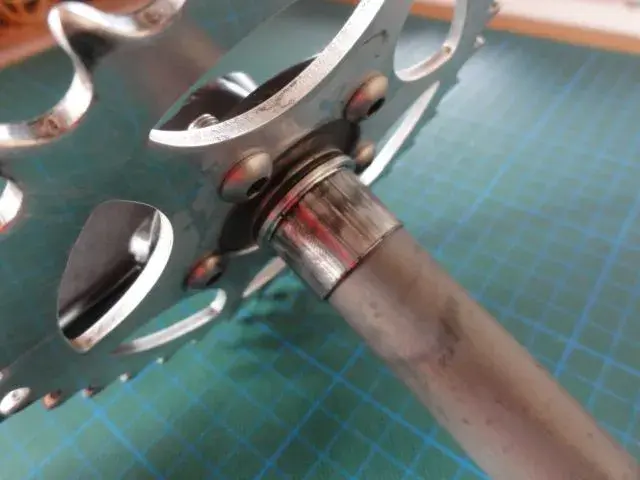

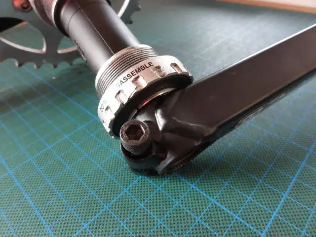

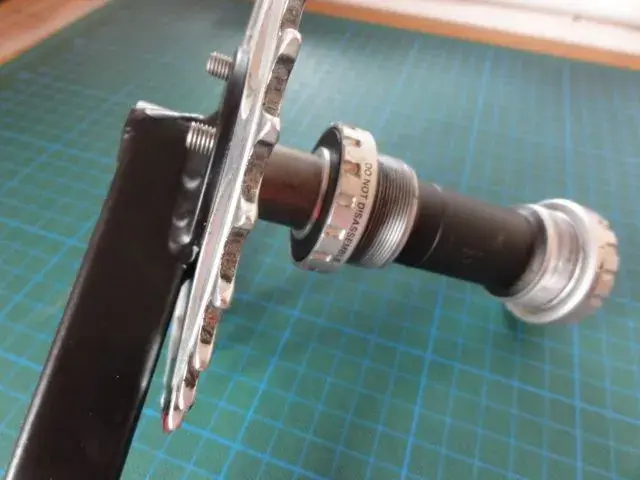

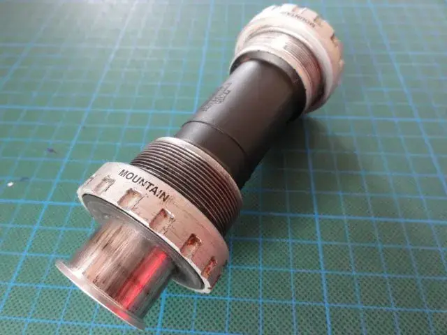

This is getting silly, maybe a few photos will help
Gen 2 crank 22.2 Spindle/TA direct mount Chainring/My Shims/Shimano HollowTech II Mountain BB
Total spindle Length 150mm ~ this includes the drive side crank arm width as well, spindle itself is around 125mm (hard to measure without removing chainring)
Hope this helps

Pictures are great; thanks.
I think, I've finally got this... :oops:
Pierre is using a BMX Euro BB which takes a 22mm spindle; hence the need to mill 0.2mm off.
A Hollowtech II spindle is 24mm, so the shims are 1.8mm.
I guess the chainline is fixed depending on the spindle length or I suppose you could you spacers?
