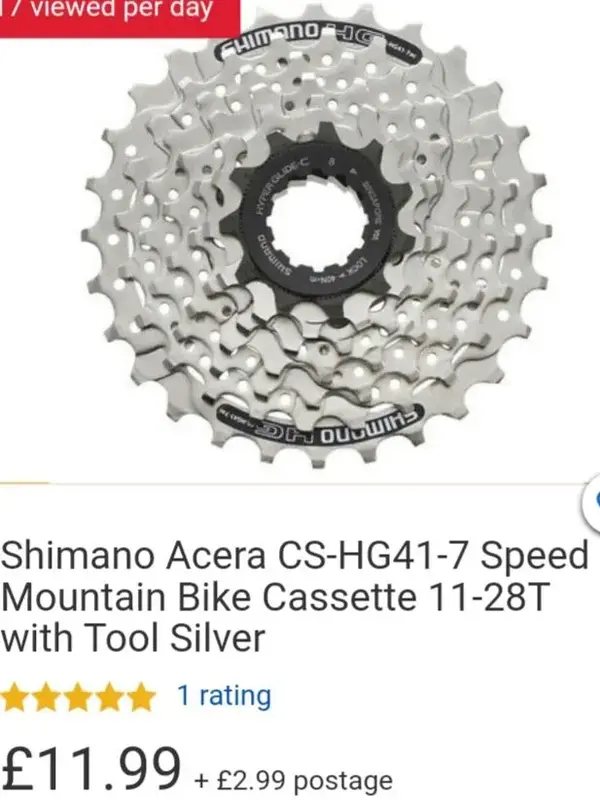

Here's a start.
Sram and shimano can be used together where chains and cassette are concerned.
Only the shifters are a different pull ratio. Personally I like sram chains, where the lowest is as good as mid range elsewhere.
A chain, be it simano, seam, other can be used with sram and shimano cassettes.
7, 8 and 9 speed chains will work on the same speed of cassette, any combo.
Personally, where convenient, I use 9 speed chains on 7 and 8 speed cassettes. Works well.
