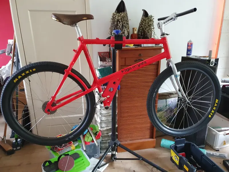

Building the bike nobody wanted. 1991 RidgeRunner.
I like Kogas, I like this frame and I like the way you're building the tension!
It does look like the crack (if crack it is) is being caused by the seat post bolt itself so your theory seems sound. And... Schrödinger's seat post 👏.

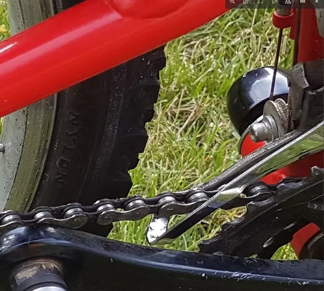

First little hurdle, I had a 31.9 M900 front derailleur lying about from a Zaskar frame I sold.
Not sure who invented this kind of system but I'm lost to why, maybe it has some physics properties that actually improve shifting but I highly doubt it.
Since the original piece was not on the bike I used one I got of a Concorde Kudu, it's plastic, hasn't got bearings so I might ditch it altogether but I need it for mock up. I tried to look for a similar part with bearings (bushings?) in metal but only came across one here from a post made in '13.
But this isn't going to work well, the way it's set up now. But it'll have to do until I can sort something else.

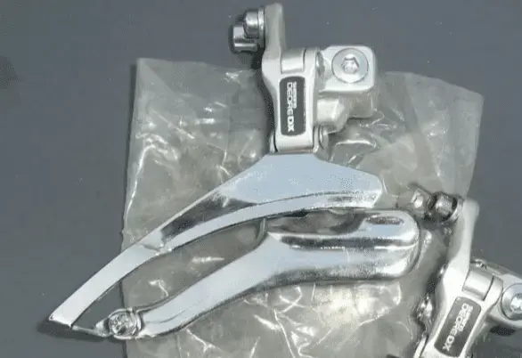

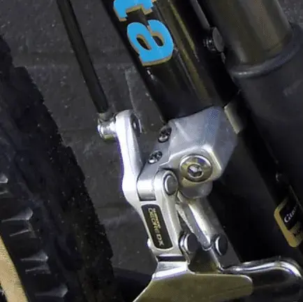

First two is from the interwebz and that's what the original looks like.
The third is mine.

I'm not sure if I can make out what you mean by the derailleur.
Also I'm pretty set on putting all M900 stuff on it, because I already own 90% of it.
Have been looking around for a better pulley and I'm fairly sure I can DIY something together that will work smooth.
