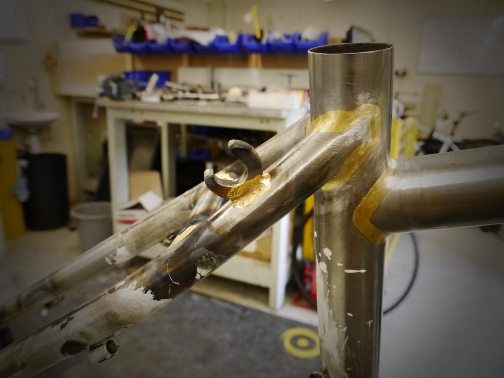

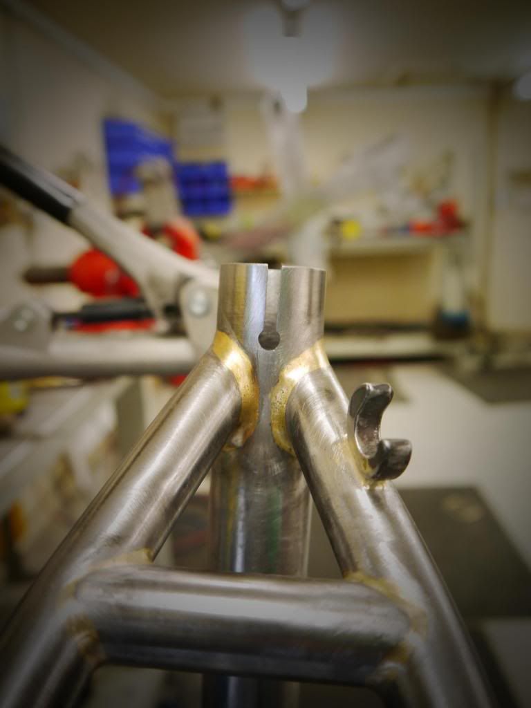

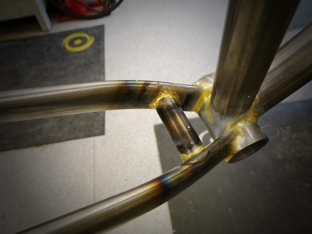

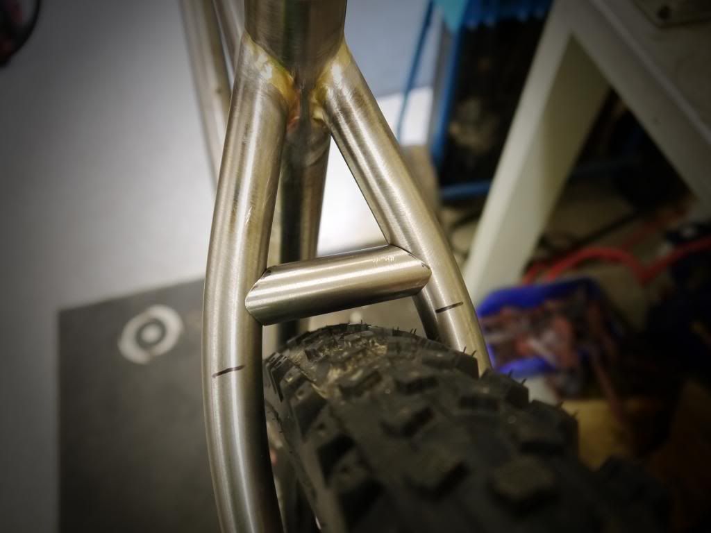

I started the day with just a few braces and braze-ons remaining to complete my frame.
I'd already mitred the braces so got straight into brazing them on...

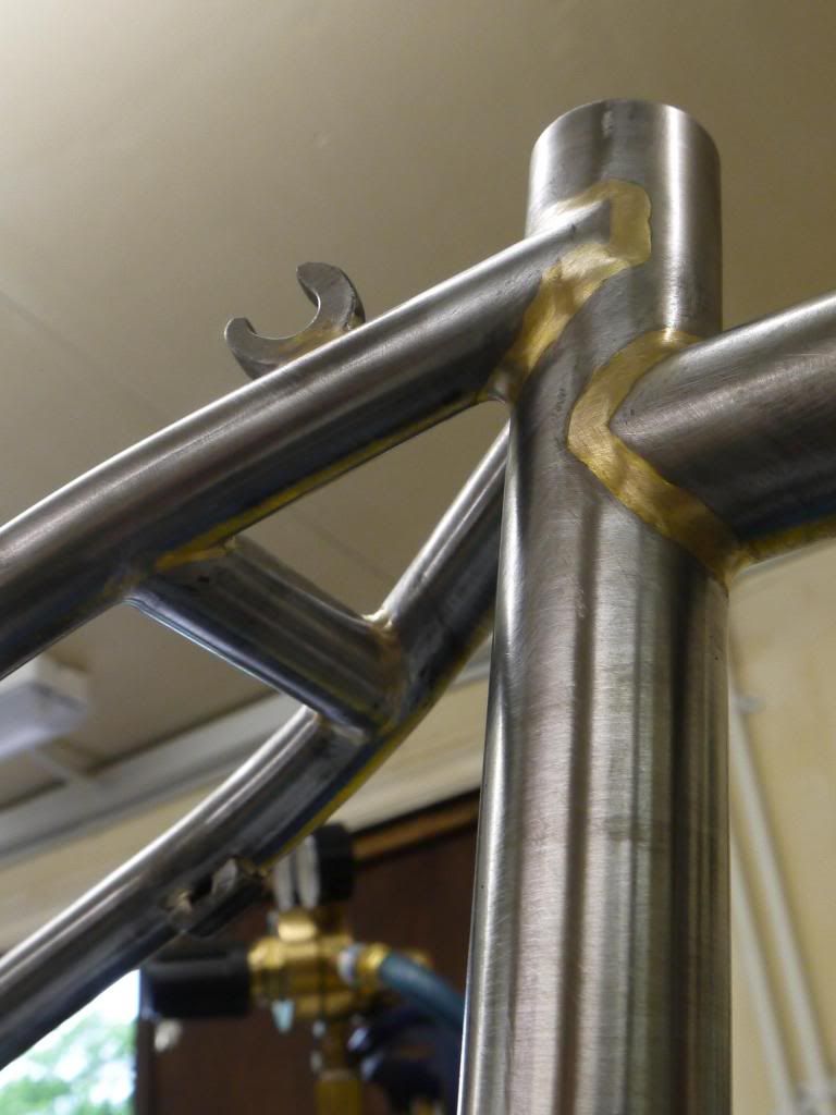

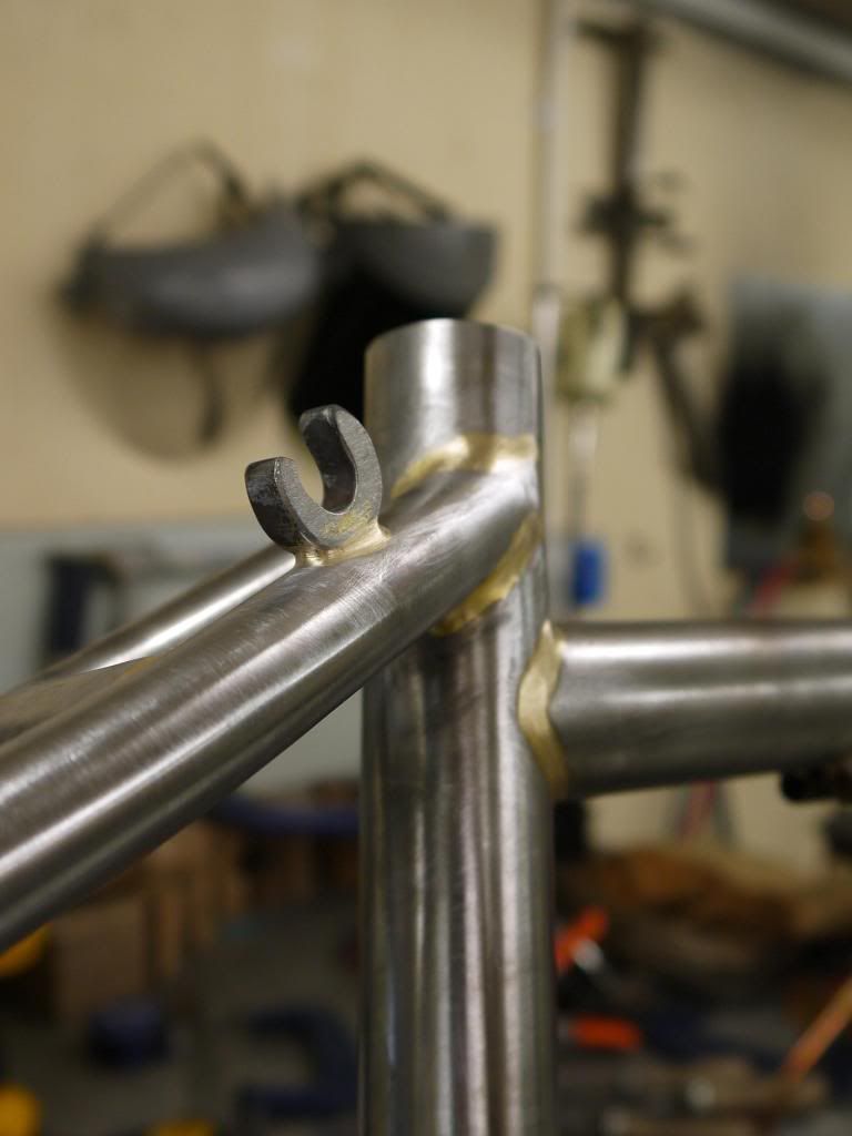

I then set about adding my own personal addition.....a bottle opener!
I'd cut this out of a spare drop-out, and pre-tested it with a bottle of Bishops Finger :D

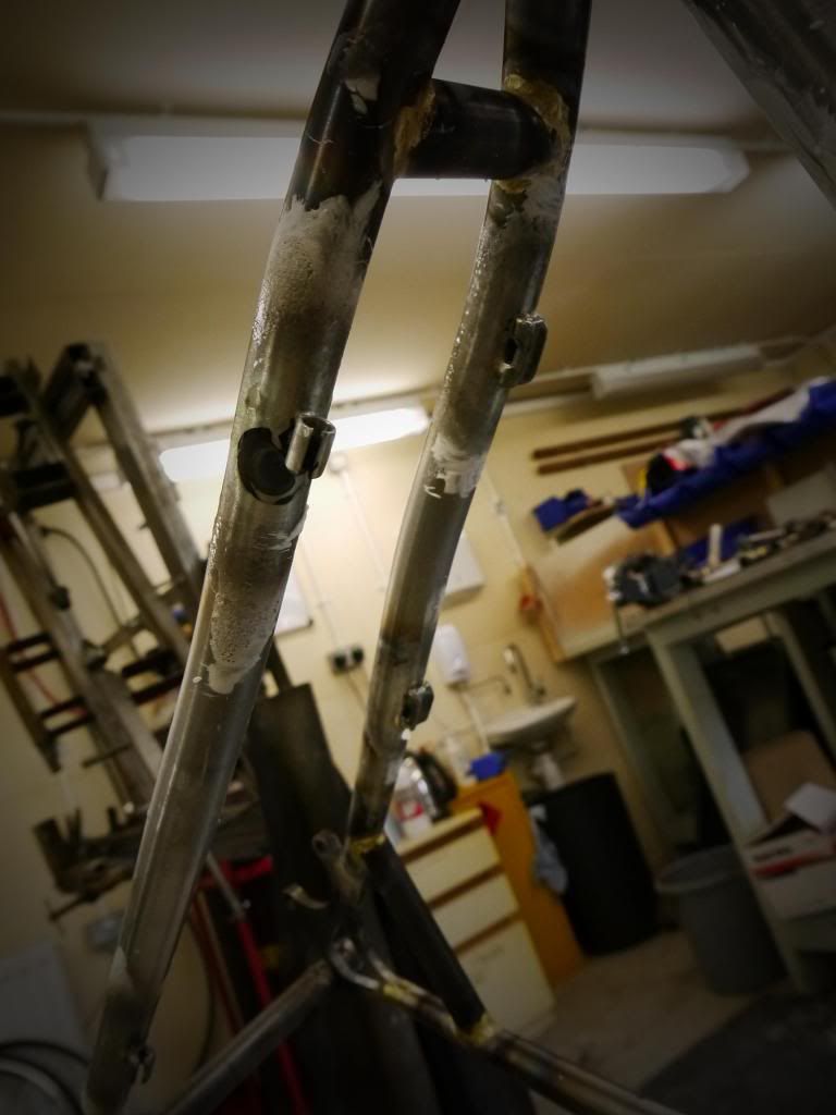

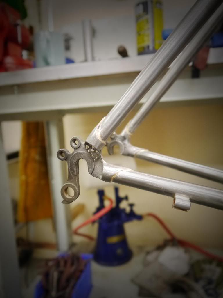

Next up was the last few braze-ons, the cable guides and disc hose clamps...
I almost over-heated one part of a seat stay, which would have been devasting so close to completing the brazing. Luckily Brian was watching over my shoulder and told me to pull the heat away.

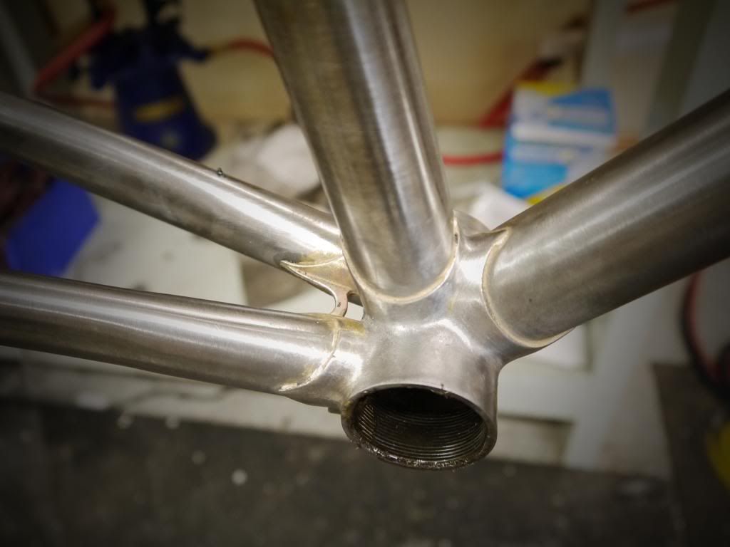

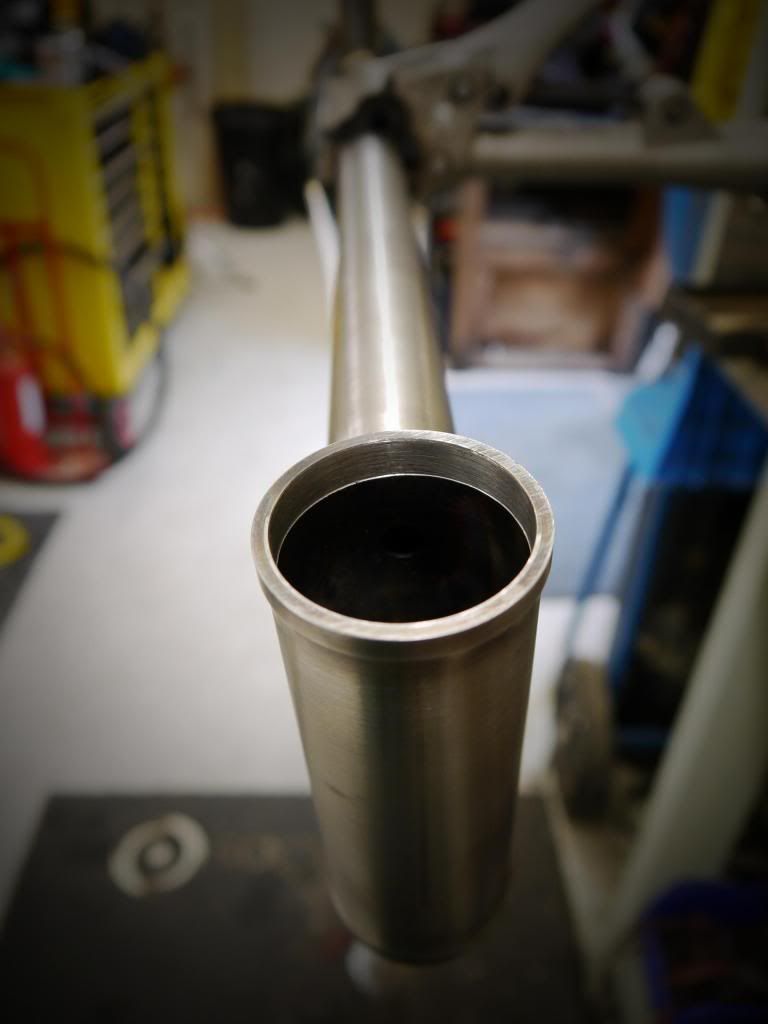

With the last of the brazing now done, it was time to clean up what I'd brazed...

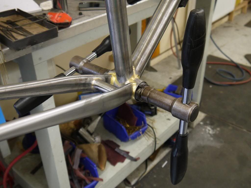

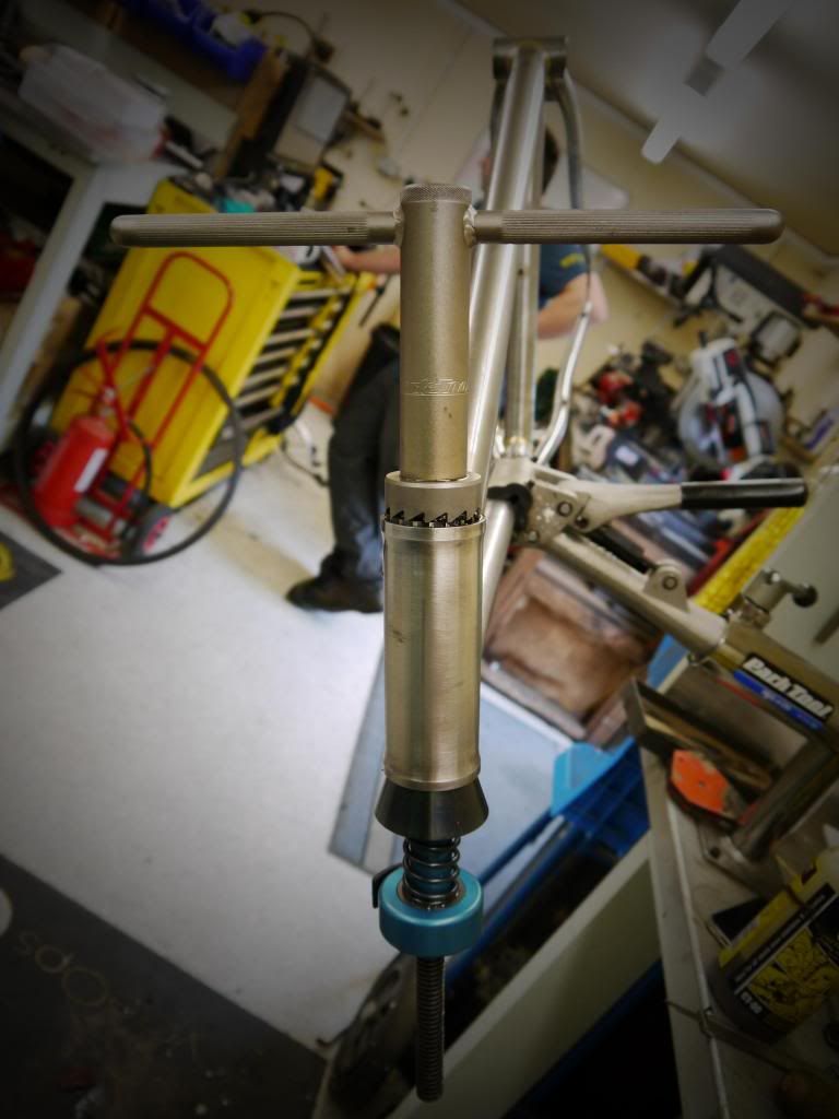

The final jobs were clean out the bottom bracket shell threads, run a reamer down the seat-tube and head-tube and then cut the slot at the top of the seat tube for the clamp...

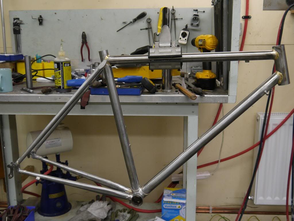

And that was me done. Brian put the frame back into the alignment jig and was very happy to report that it's straight!

I'm completely chuffed with how my frame turned out. It's exceded my expectations by a long way!

have you gone for a replaceable mech hanger? I would, i noticed that the other guy hadn't.

I was restricted on the drop out selection by what they had in stock.
