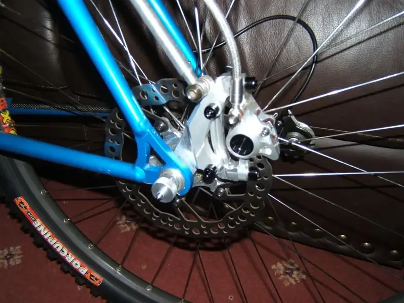

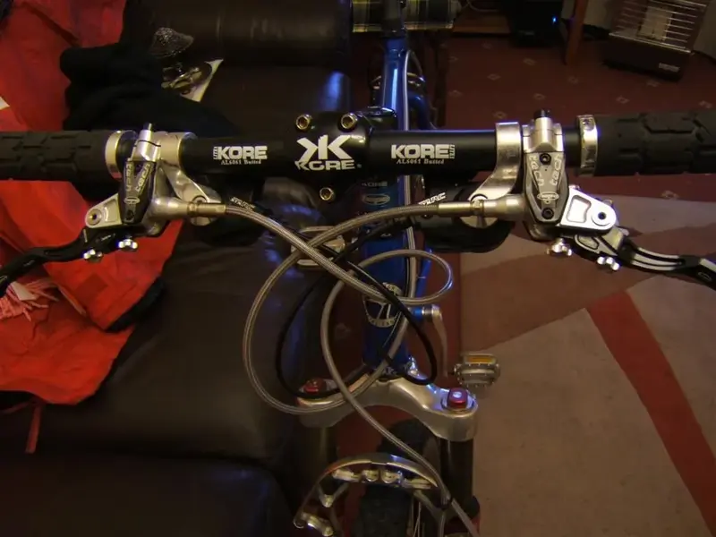

I stuck to Hope :D
Tight fit on the shifters but thats down to the badly placed windows,i reckon plain XT ones with fit no problem
The lever are very nice and they look quite robust but sleek at the same time.I think this lever is used in the X2 V2 X4 etc with only the calliper changing,,at least hope is sticking to a proven formula :D
The calliper is pretty simple looking but is sculptured all nice 8),well set out with a better placed banjo and bleed nipple[drip free].
It says you load the pads in from the top so you dont need to remove the wheel.
Its post mount and they have elongated holes that make fitting easier,you dont need shims,slide to adjust,then tighten up.
I havent used them yet,they come back Wed,ill give you an update when ive tried them out.
The only downside i can see so far,is the hassle with the shifters :?
[Hoses are being cut shorter :wink: ]
