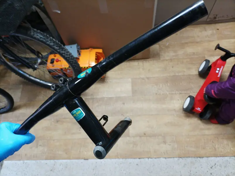

I have the original ITM bar and stem from one of these if you want them
Thanks, it would be really nice to have the original items. How much would you want for them?
I do have the original saddle with a rather loverly embroidered 'British Eagle' badge. Not the nicest saddle but would probably be impossible to ever find another, so it will stay with the bike - not that I could ever imagine selling.
Moto

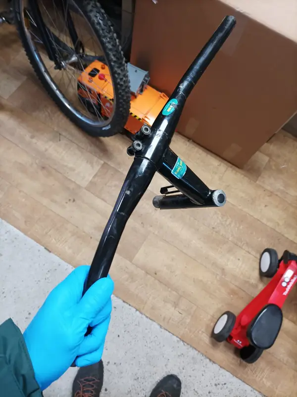

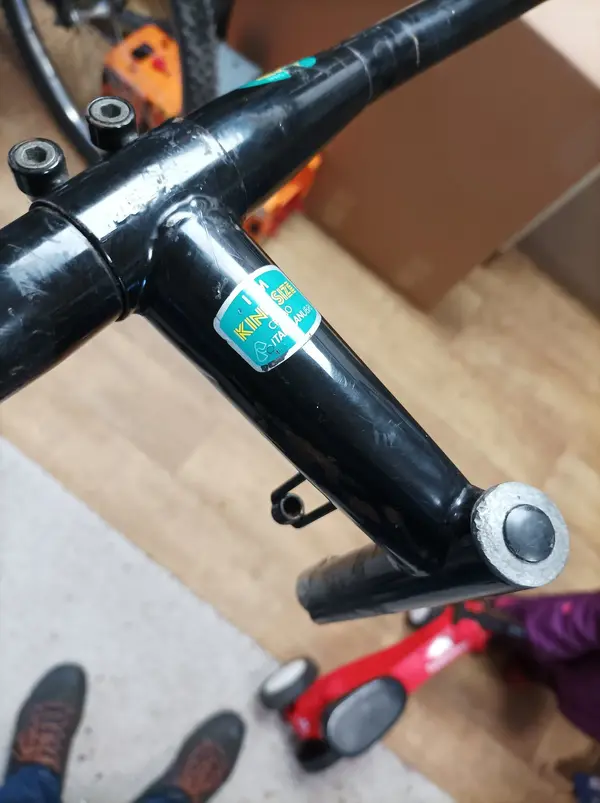

Hi it's a little curious as it's a rare ITM king size, 31.8 bar long before the rest of the world started with 31.8 bars. This means you can fit modern carbon bars if you wish....
I have other original parts e.g. st-m095 with the SLR windows
I don't know much about these things but they're not nice looking bars/stem - very similar to those fitted to my mid range (Exage) BE from 1990's. I did read somewhere that British Eagle were trying to compete with top end bikes for a period but although they did some nice frames with quality XT kit, they let themselves down with cheaper saddles, grips etc.
Regards the shifters, the Pro-Carbon catalogue shows the bike wearing and spec'd with XT thumbies.
Moto
The catalogue and real life are different! The catalogue would be prepared the year before, before parts were available to photograph a d specs tied down.
Mine came with that bar and stem and st-m095
Mine was the revised top of top tube cable routing "green dash" model.
Early frames had cable under top tube
British eagle stuck some weird choices on, you should see how hard the grips are it came with
