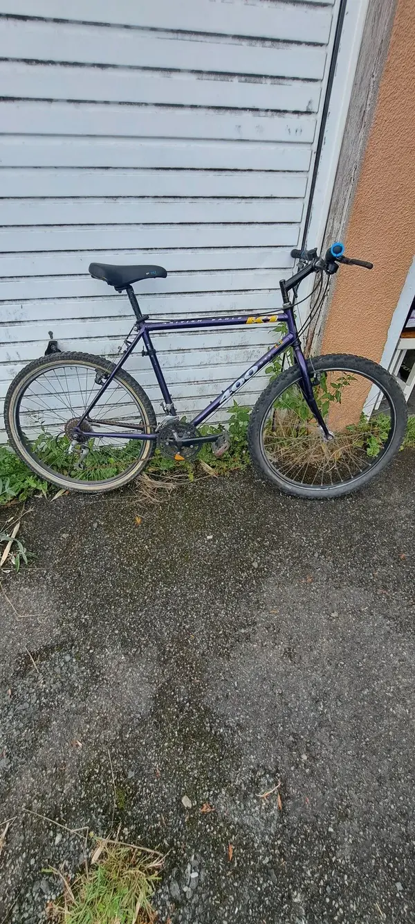

She's looking grand, good job, here's one I picked up today for £25. Any help on the year would be greatly appreciated.
