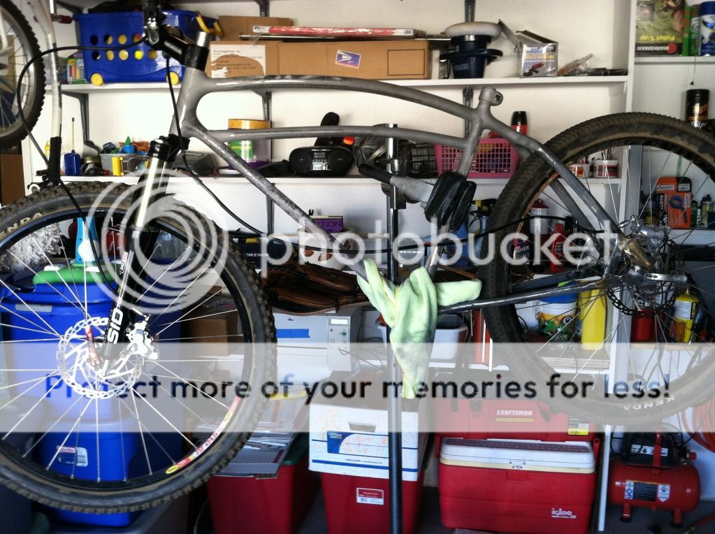

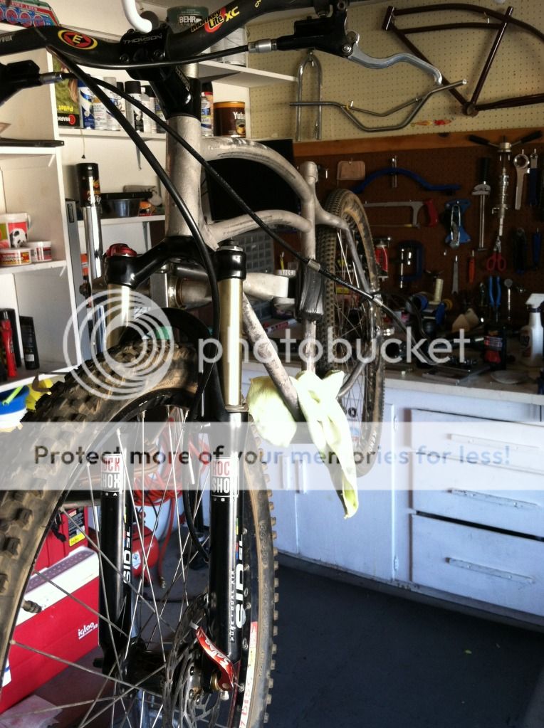

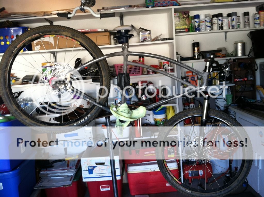

I got it mocked up today so I could work out the cable routing. Only then did I realize the brakes were set up as lefty rear and righty front. Gonna chang that for sure. I am thinking of going with a matte black finish, custom decals and headbadge. I have the cable stops and guides and I will be brazing them on later this week (I am too shitfaced right now) Anyway, I shall christen thee the Marauder. You shall be the meanest most rediculous bike in the realm. Cross country fork, downhill brakes on an antique frame, screw it why the hell not. Seriously, this bike is so completely impractical and off the wall, it totally makes no sense. Just like me.
