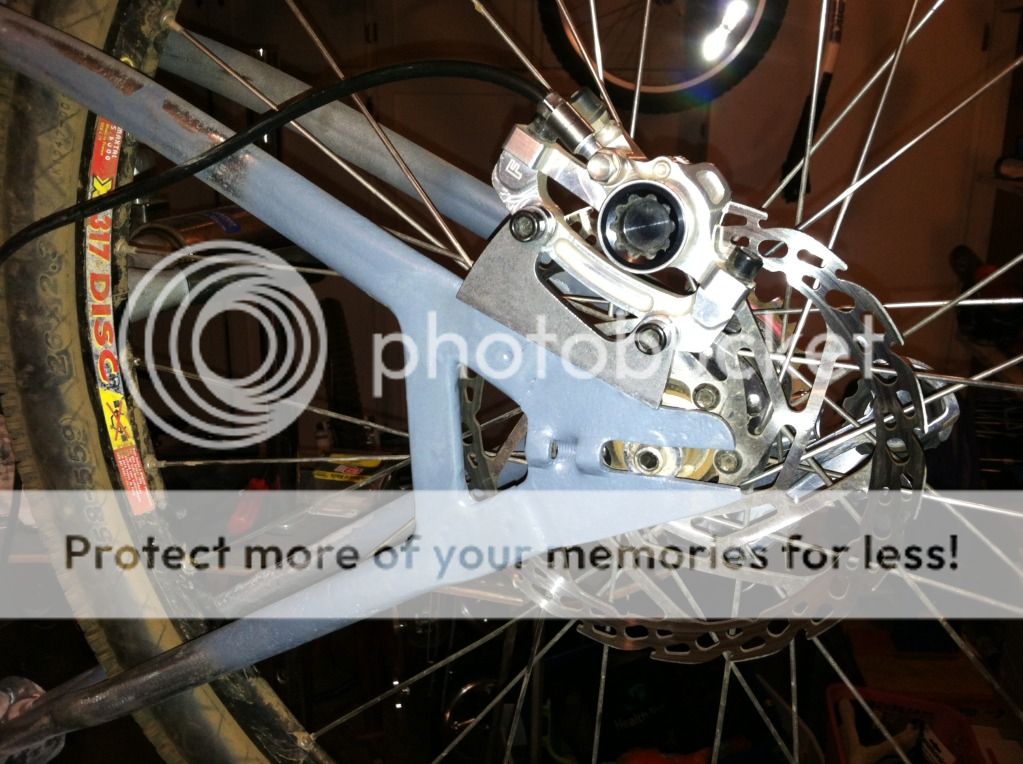

Can you fasten your disc tab to the rear triangle brace?
No, due to the spacing originally being only 114mm and cold set now to 135 the chainstay is too close to the rotor when the wheel is mounted. The disk tab will have to be mounted over the dropout if it will work at all. I have the disk mount on its way. I could have made my own but the steel ones from Pacenti are only $6 bucks. Once it gets here I will know.

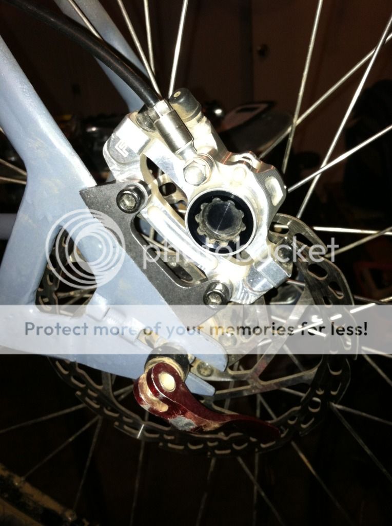

So I made a little progress today. I am sure now that I can pull this off.
I got the disk tab in today and tried it on for size. Untrimmed like this was a no-go. I would never be able to get the wheel on an off without messing with the brake.
So I trimmed it a bit, still rough but after some grinding and filing it should fit flush to the top of the seat stay. Then I will strip that primer back off, sand it with 80 grit so the brass can get a grip and then I will lay a fat bead in there. This way I can take the wheel off without any fuss.
