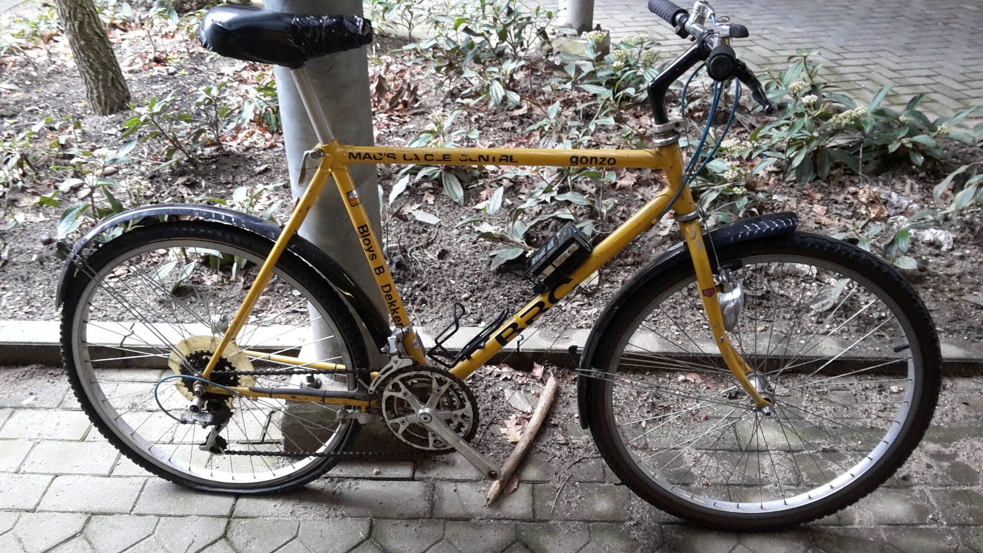

Well, just about finished with the Haro, so thought it was about time to get a build thread started on this one.

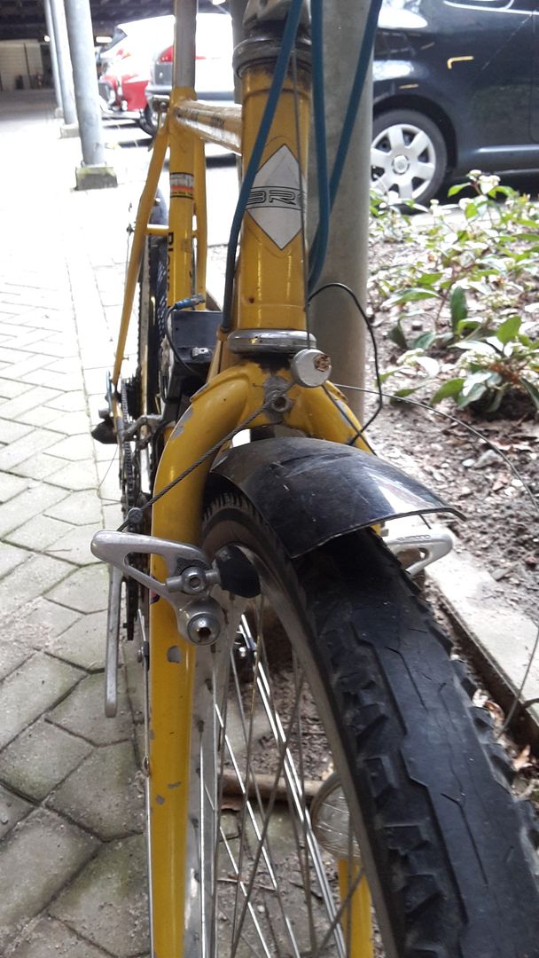

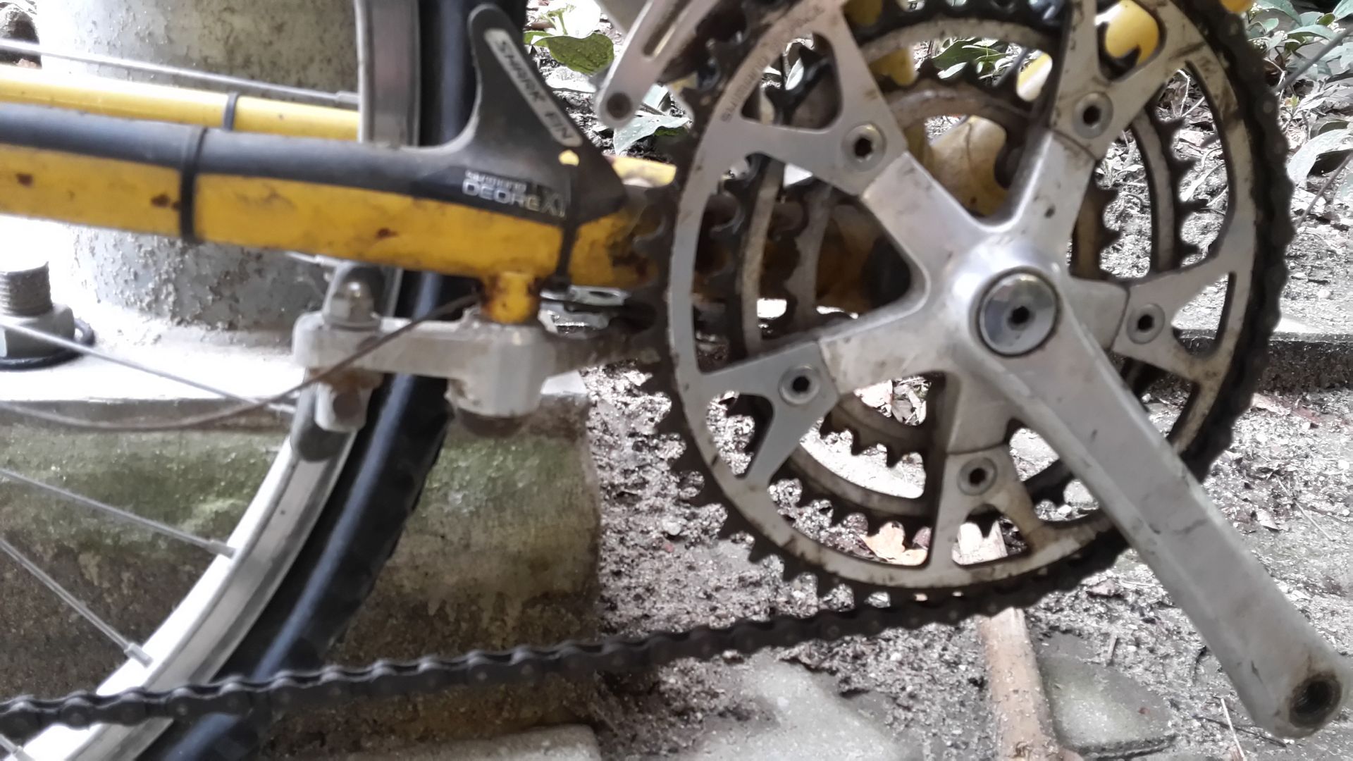

Started off a few months ago with poorly photographed ad on marktplaats. Geometry looked interesting, could see the chain stay mounted rear brake, but looked too slim to be a u-brake in the photo (possible rollercam?). So I took a punt, made a bid and a couple of days later went to inspect and pick it up. Was really happy to find an interesting bike with a mix of parts. I bought it only because of the suntour roller cam brake. Never had a bike with one before.
Bike is badged as a BRC Gonzo. Quick google search reveals it was a Canadian company importing Japanese or Taiwanese frames for the North American market in the late 80s and early 90s. Not very highly regarded though. This fitted with the owner story that the bike was owned by a Canadian relative who moved back but left the bike in NL.
First thing I did on getting the bike home was cut out the cables and clean up around the bb to see if I could find a frame number to help trace the frame origins. Frame number was barely decipherable apart from the first three giveaway letters ... ARY ... an Araya made frame.
Araya have PDFs of all their catalogs online.
http://araya-rinkai.jp/wp/wp-content/up ... e_1988.pdf

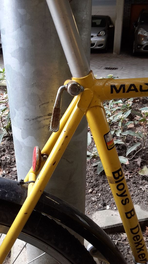

Quick search reveals the same frame as the 1988/1989 MF-26 pro. Same lugs, same detail around the top of the seat stays, same seat post mounting for a pump...
Photos next.

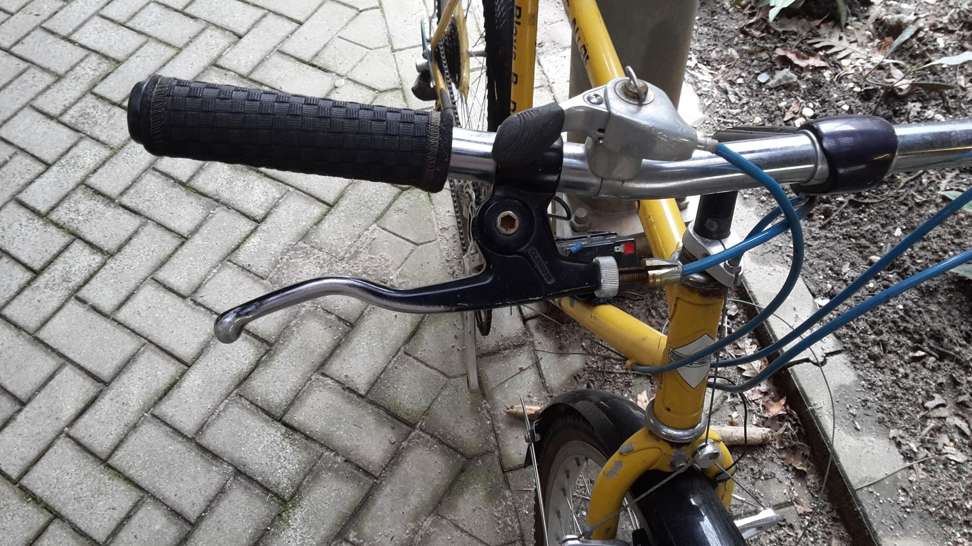

Bit puzzled by the odd mix of components. Original wheels and rear mech are long since gone. Brake levers are early bl-m700, mated with br-m730 front cantis. Shifters are suntour hidden band type, not sure of the exact model ... need to check the catalogs.
I'm converging on a plan to make this a drop bar tourer, with rear and possibly also front racks, with top bar mounted shifters as per the Araya catalog. Paint is pretty poor, so will have to be redone, likely dark blue or green. Not going to be badged BRC, but also won't make it look like a full MF-26. I am tempted to put a single Araya badge on the head tube though ... I think that should be ok.
