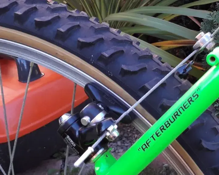

I had the same needs on my palisades.
The rear I changed to the suntour self energise jobbies, came with their own blocks too. Were...on ebay rather cheap. The front just got new ritchey pads, mentioned above.
That bike went were any other bike did. No obvious sign of death to rider.
