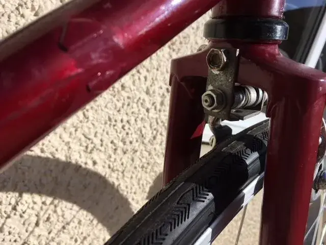

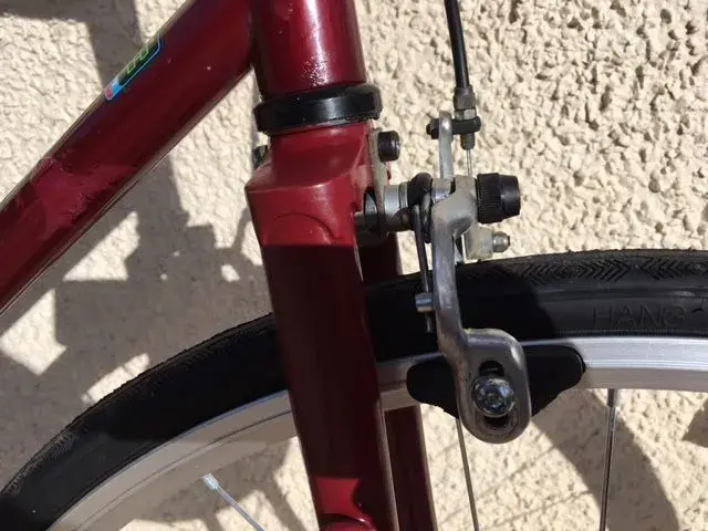

I've installed the drop bolt on the bike, took me some time and a lot of swearing but it worked out well! As lewisfoto said, it added some flex on the braking performance, but it still works very nicely. I'll keep this solution until I find some cheap long reach GS or record calipers!
Pictures can be found in this topic: viewtopic.php?f=23&t=238076&p=1786805#p1786805
Re: Brake drop bolt DIY
Here is my take on Sheldon Brown type suggestion to solve this problem. Works perfect on my fixie/single speed.
