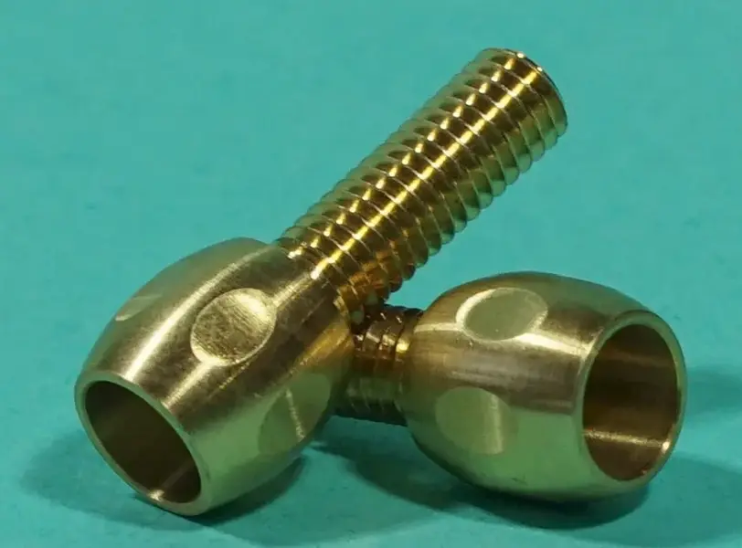

Iirc, on the avid ultimate levers, the adjuster isn't threaded in, it slots into the lever and adjusts within itself if you get me. Very much like the inline adjuster I guess.
For the barrel adjusters (or just as stops), there are some very nice brass ones available for frame gear adjusters.
M5, they are designed with a stainless spring, but you could have a plain brass M5 nut to lock it. Un-slotted, though🤔
I got mine from Peter @ Ceeway, and have a few spare sets if you're interested.

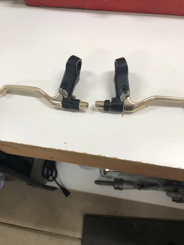

Cheers, I've designed the perch with the holder integral.
They're coming along nicely, I'm just waiting for the return springs to arrive before I make the moulds.
