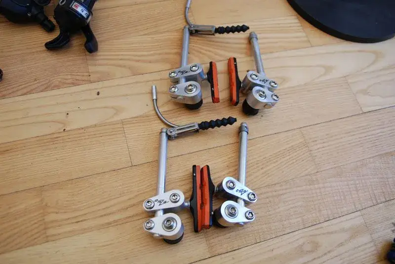

are onza ho's v brakes?
no, but onza made v-brakes. they were called onza hola.

those onza brakes look like they'd fit right in. cant say i have seen them before but i will certainly keep my eyes peeled
