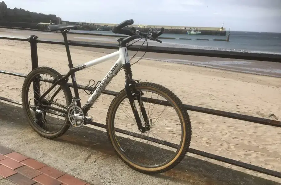

Thanks for the offer. The Black Tioga Power studs are now on the F400 as I've changed to Ergon grips with bar ends on the F700 at the request of my wife!
Also changed out the Headshok headset for the brand new one, and play in the headset was instantly solved! - Salvaging this from the original £25 frameset simply wasn't worth it, even though I'd had the cups re anodised :facepalm:
Rear mech changed for a long cage DX. Functions far better in the lower gears now.

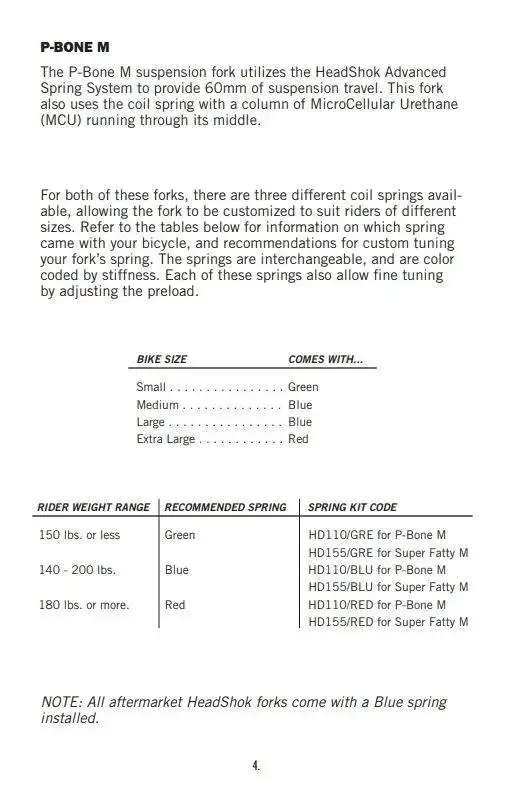

Did you say you had the forks powder coated?
I want to powder coat a Delta V with P-bone forks, but assumed that removing the elastometers etc (to go in the oven) would be too much hassle?

Heavy":93ae3mg6 said:
Nice bikes - my F500 is in the team blue but with silver decals - US spec I think.
Thanks Heavy ! :D
Yep. I had the forks powder coated in black by a local firm. Decals from eBay were then applied to a Scotchbrited surface and then 3 coats of clear coat applied.
To be honest, I was unaware that the P-Bone M forks had a polyurethane elastomer core. :oops: ( Until I checked the owners manual just now!)
- I though they were just the cheapest version of the headshok that used just a spring rather than an air cartridge.
The heat of the powder coat hasn't seemed to affect the function - maybe they were never there in the 1st place? - no melted residue from the elastomers was present when i got them back from the powder coaters.
It would probably be smoother if the elastomers were replaced though. :?
I'll see how I get on with the F400 in the Isle of Man this week, and evaluate from there.
If it's just me and not the family riding, I'd probably take the F700 or Orange 5 instead as both of these are dialled in 'just right'
I've added the article I've found relating to the P-Bone M if it helps. I think there's also a P-Bone D that's adjustable.
Cheers.
boy"O"boy

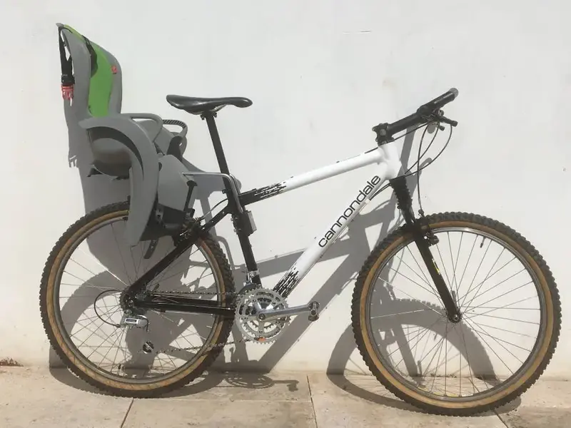

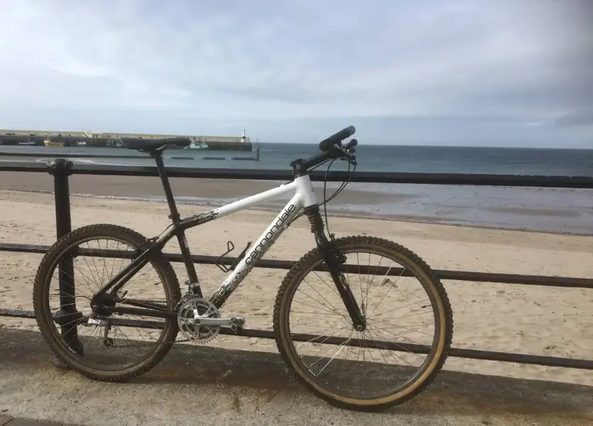

So. After a fair bit of riding - Isle of Man / summer holidays in France / Rutland water - I've come to the reluctant conclusion, although I should have known this at the start :facepalm: :facepalm: That the F400 is too small for me. :roll:
With the Child seat on, I'm catching my heels on the footrests of the seat. The F700 is slightly bigger and I can just about get away with the sizing, but trying to make the F400 work with a 15" frame size / 350mm of seat post extension / and a 140mm stem is just not going to work long term.
So. 2 options -
i) Look for a bigger Cannondale frame and move everything onto that.
ii) Move the parts onto something else and sell the Frame/Forks/Bars/Stems
Any interest in the Frame/Forks / Headset here before I place an ad/eBay?
Here's some pics showing it getting used!
Cheers.
boy"O"boy
