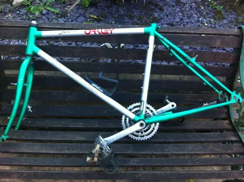

Need advice/help on the following. I have finally got my brother to agree to take my old 18" Dyna Tech apart and send the frame to me in New Zealand so that I can get the old girl up and running again (see picture below).
Getting quotes is tough. Have found an online outfit (www.parcelflight.co.uk) who have quoted GBP65.00 which is awesome. Weight is not a problem (as calculated on cubic weight)..... however measurements for the length can not be greater than 100cm. Therefore packaging for the frame needs to be SPOT ON. I can't measure the actual frame, but best guess using brochures I've found on RB show her to be just under 100cm headtube to dropouts (phew).
