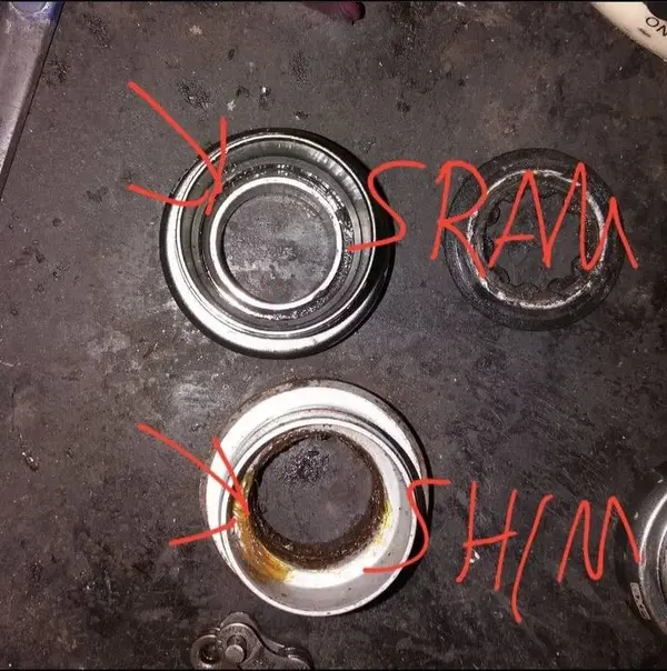

It's an sram made bb, you'll be able to press the bearing out to service/ replace it.
Pick the seal off, flush it clean and repack with your bike grease.
Unlikely to be reason for a creaks though. That's dry threads normally.
