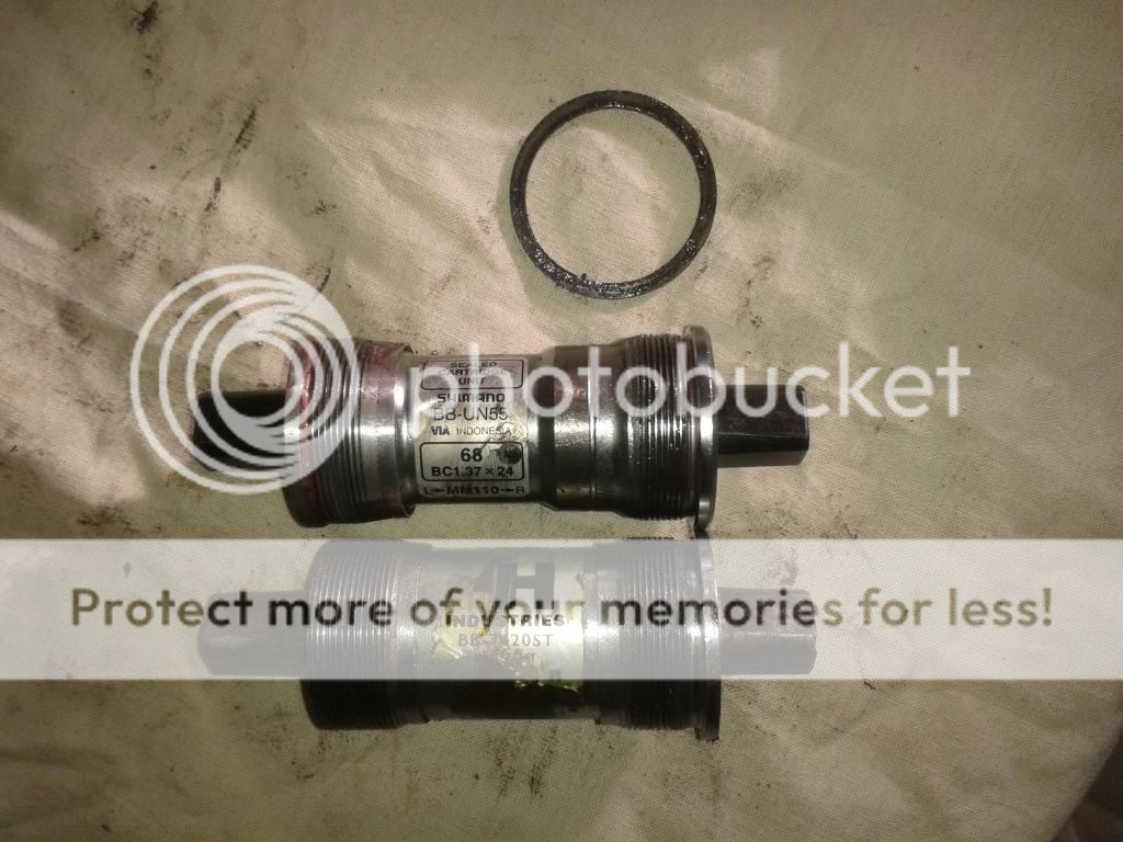

Pictures
Yes, I know the spindle lengths look different but they're not - both 110mm.
The Shimano one is brand new, the TH one very old.
