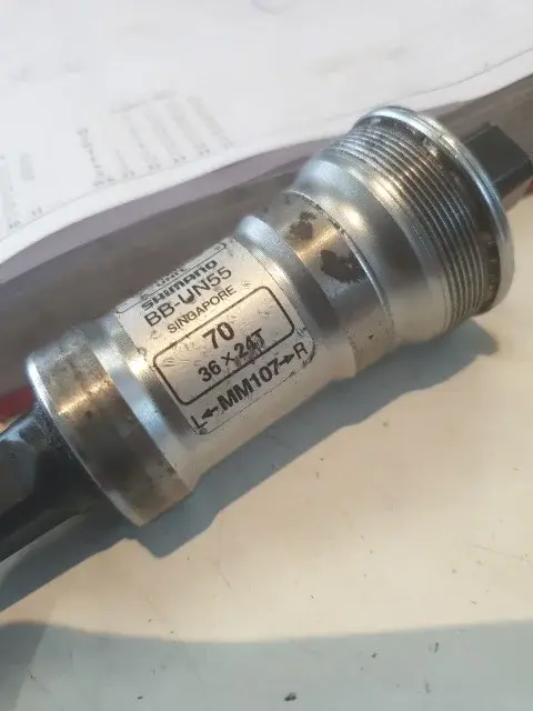

There are two lengths of taper on the end of a "square taper" axle.
You really ought to use the right one. If it's a shimano chainset, it'll be j.i.s.
Most other brands are too.
Campagnolo and other European quality racing chainsets are ISO.
Here's the lowdown:
https://www.sheldonbrown.com/bbtaper.html
Skip the first bit, youre dealing with cartridge bb.
It's the stuff about the tapers you need to read.
BTW, I removed the bb and it's 107, not 122.
I managed to remove the other cup, pretty easy using a 40mm waste pipe and rubber mallet, it fits perfectly.
the other one I have is 113, so no good I suppose.
