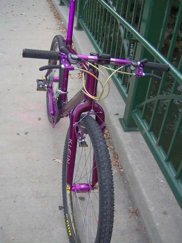

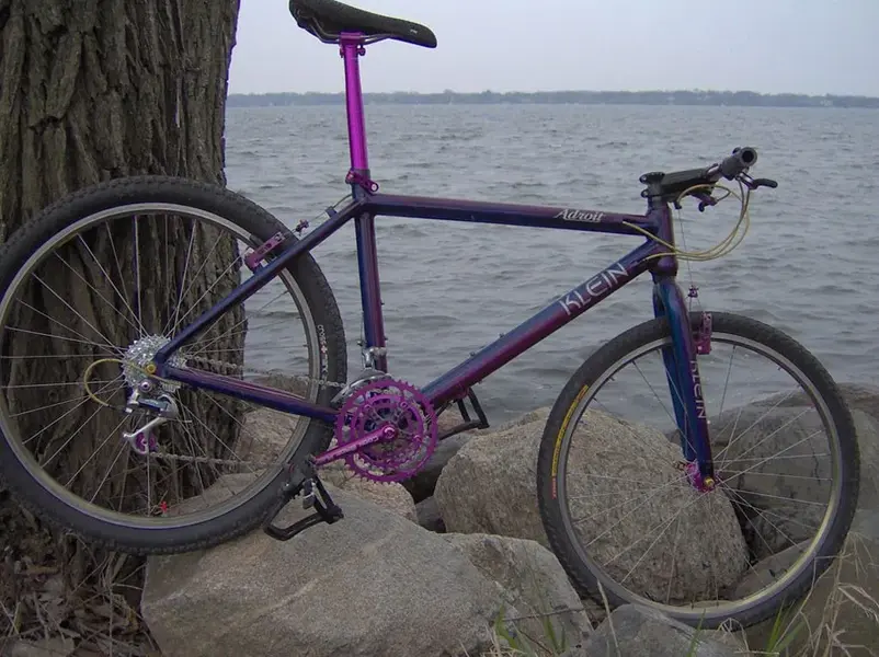

Here is a bike that was helped along by several members of this forum...I bought the small purple chainring from retrobikeguy, the large chainring from slimjoe, and the seatpost from elite504. Thank you all for your help.
When I bought this frame last May I had decided that I wanted to use the cantilever brakes that I already owned, however this particular frame was set up for v-brakes and it didn't have a noodle or cable guide installed. Because the steer tube is oversized I had to get a 1-1/4" cable guide and then dremel out the inside. I got lucky that the cable guide I found was thick enough to maintain it's integrity while having half of the metal shaved off. My main complaint of the final product is that the gold cables don't really seem appropriate for the build. The gold cables looked OK at the bike shop, but not so good installed.
