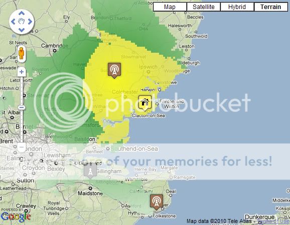

lgf. . . that's the aerial I bought... 8)
The picture quality is excellent when it's there.. startlingly good, in fact..
Apparently the aerial was fitted professionally, so should be in the right direction (and it points in the same direction as all the others I can see)..
I'm not saying it's 100% right but the indications are pretty good ;)

Where I live my signal quality is low for some of the MUX's until the changeover but ours changes late in the game next year.

This website
http://www.ukfree.tv/
is the best for info I've found. Tap in your postcode and you'll see all the details of you transmitter and works/problems. Also looks like they have more stuff now :D

Using the ukfree link . . . .
Where we live the signal is really poor.
Installed a mains powered amplifier that has a receiver(?) up on the ariel.
Seems to boost the signal to both TV feeds.
Could get nowt before, get the full channel listing now.
Item is a Wolsey WPS100/1
